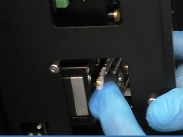

    3. Wire Bonder Thread Spool Replacement, Placing the thread into the infeeder: step 4, image 1 of 1
      • Place the thread between the guides of the infeeder.
      • Pull the engaging knob which is situated to the left of the infeeder rolls, to the left.
      • Now there is a gap between the infeeder rolls into which the wire can be inserted safely.
      Ask FixBot
