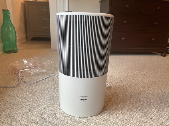

    1. Winix C610 Filter Replacement, Filter: step 1, image 1 of 1
      • Unplug the device

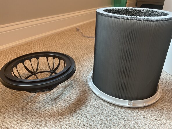

    7. Winix C610 Filter Replacement: step 7, image 1 of 1
      • Remove the filter by pulling up
      Ask FixBot
