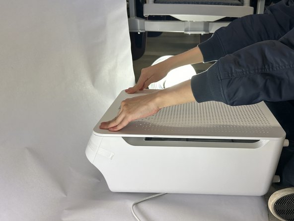

    1. Winix C545 Filter Replacement, Filter: step 1, image 1 of 1
      • Ensure that the Winix C545 Air Purifier is unplugged from any electrical outlets.
