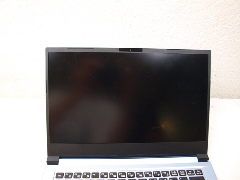

This guide shows you how to replace the screen of a why! NV41MZ. Plan to lightly heat the edges to soften the adhesive before removing the frame.
    1. Why! NV41MZ Screen Replacement, Screen: step 1, image 1 of 3 Why! NV41MZ Screen Replacement, Screen: step 1, image 2 of 3 Why! NV41MZ Screen Replacement, Screen: step 1, image 3 of 3
      • Gently heat the edges of the screen from the back to soften the adhesive on the frame and the screen itself.
      • Do not stay on the same spot for too long.
