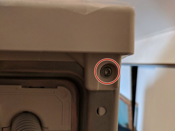

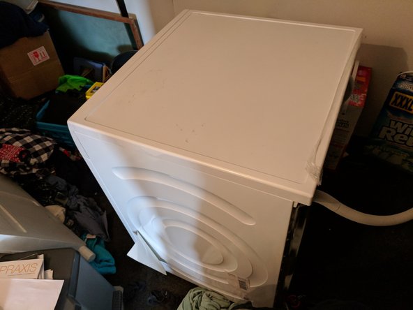

    2. Washing Machine Disassembly to Access Water Drain Pump, Remove top cover: step 2, image 1 of 3 Washing Machine Disassembly to Access Water Drain Pump, Remove top cover: step 2, image 2 of 3 Washing Machine Disassembly to Access Water Drain Pump, Remove top cover: step 2, image 3 of 3
      • Move washing machine away from wall to make rear and front accessible.
      • Using Torx T20, unscrew two screws (top left and top right on rear side) .
      • Slide top backwards, lift it off, and put it aside.

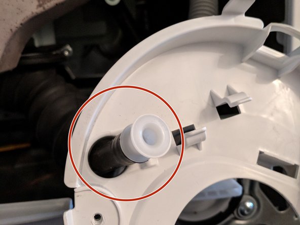

    3. Washing Machine Disassembly to Access Water Drain Pump, Remove detergent dispensing tray, and 3 screws: step 3, image 1 of 2 Washing Machine Disassembly to Access Water Drain Pump, Remove detergent dispensing tray, and 3 screws: step 3, image 2 of 2
      • Push down blue part in the middle to release the tray, and pull it out completely.
      • Unscrew three T20 screws; the one on the lower right is shorter.

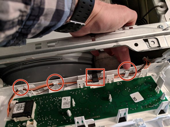

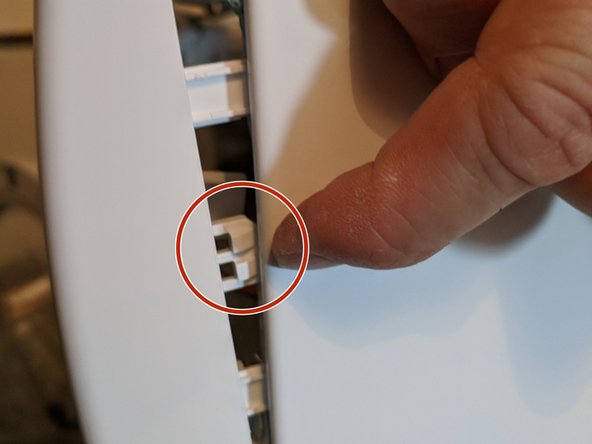

    4. Washing Machine Disassembly to Access Water Drain Pump, Remove control panel: step 4, image 1 of 3 Washing Machine Disassembly to Access Water Drain Pump, Remove control panel: step 4, image 2 of 3 Washing Machine Disassembly to Access Water Drain Pump, Remove control panel: step 4, image 3 of 3
      • Unhook three hooks at the top (two shown).
      • On the inside, on the right, there is another hook (marked), sitting between two guiding notches without hooks.

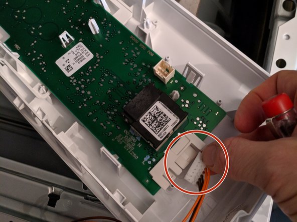

    5. Washing Machine Disassembly to Access Water Drain Pump, Disconnect control panel: step 5, image 1 of 3 Washing Machine Disassembly to Access Water Drain Pump, Disconnect control panel: step 5, image 2 of 3 Washing Machine Disassembly to Access Water Drain Pump, Disconnect control panel: step 5, image 3 of 3
      • Release the cables by gently pressing the hooked guides. Note that the black part (marked by a rectangle) must be unlocked.
      • Finally, unlock the connector (e.g. with your nails or a flat-blade screwdriver) and pull it out.
      • Put the control panel aside.

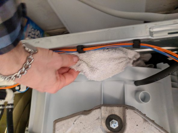

    6. Washing Machine Disassembly to Access Water Drain Pump, Immobilize the tumbler unit: step 6, image 1 of 1
      • The drum is freely suspended. Wedge a towel on the rear side behind the drum to immobilize it. This will prevent damage when tilting the washing machine later on.
      • DO NOT FORGET TO REMOVE THIS when reassembling!

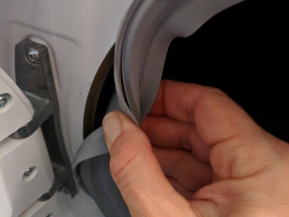

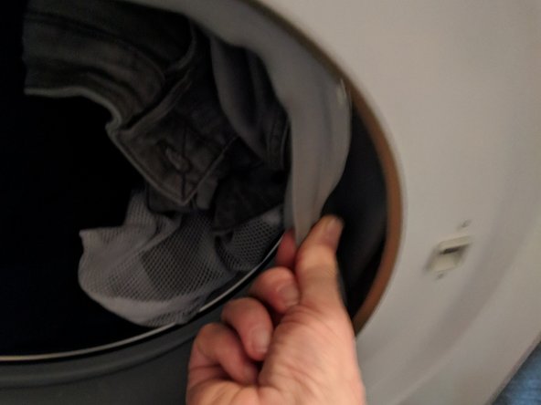

    7. Washing Machine Disassembly to Access Water Drain Pump, Detach door seal from front cover: step 7, image 1 of 3 Washing Machine Disassembly to Access Water Drain Pump, Detach door seal from front cover: step 7, image 2 of 3 Washing Machine Disassembly to Access Water Drain Pump, Detach door seal from front cover: step 7, image 3 of 3
      • The rubber door seal is attached to the front cover by a metal wire and a spring.
      • Pry out the spring and pull away the wire.
      • Unpeel the seal all the way round, and tuck it inside.

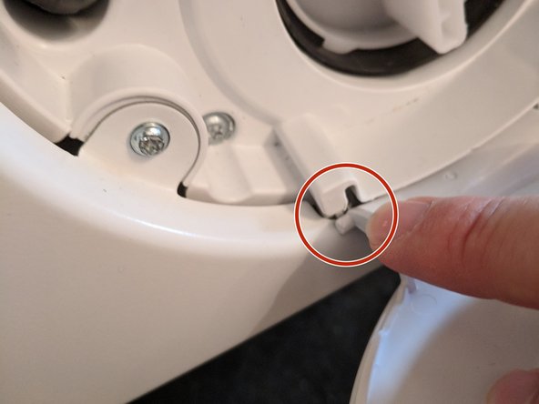

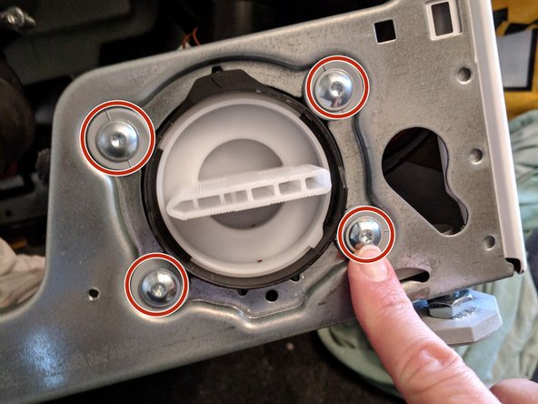

    8. Washing Machine Disassembly to Access Water Drain Pump, Remove drain/filter door, drain water, and unscrew: step 8, image 1 of 2 Washing Machine Disassembly to Access Water Drain Pump, Remove drain/filter door, drain water, and unscrew: step 8, image 2 of 2
      • The round door (front bottom right) for the drain tube and filter can be removed, by opening it completely, and gently pulling out the left side of the hinge.
      • DRAIN ANY REMAINING WATER.
      • Unscrew two T20 screws.

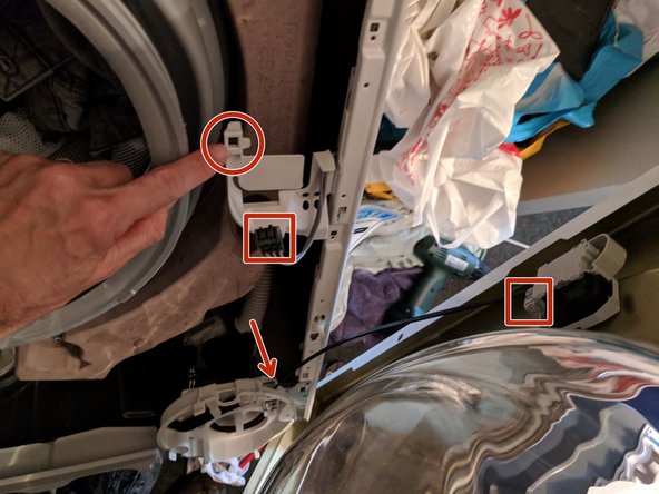

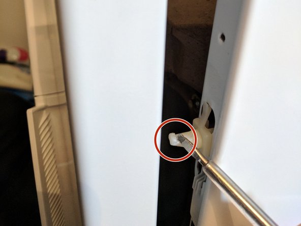

    10. Washing Machine Disassembly to Access Water Drain Pump, Remove front cover: step 10, image 1 of 3 Washing Machine Disassembly to Access Water Drain Pump, Remove front cover: step 10, image 2 of 3 Washing Machine Disassembly to Access Water Drain Pump, Remove front cover: step 10, image 3 of 3
      • The front cover is held in place by plastic hooked pins. Slightly lift the front cover to unhook it.
      • On the inside, unclip something, and pull out a connector (for the door lock). The plastic emergency door release comes out easily. The image shows this when clip and connector are already disconnected.
      • DO NOT FORGET TO PUT ALL THIS BACK on reassembly!

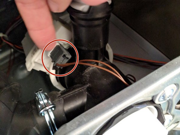

    13. Washing Machine Disassembly to Access Water Drain Pump, Disconnect pump: step 13, image 1 of 3 Washing Machine Disassembly to Access Water Drain Pump, Disconnect pump: step 13, image 2 of 3 Washing Machine Disassembly to Access Water Drain Pump, Disconnect pump: step 13, image 3 of 3
      • Pull the power connector from the pump.
      • Using pliers, loosen the clamp on the hose from the tumbler and slide it back.
      • Remove the hose.
      • BE PREPARED FOR SOME WATER (use a towel or bowl).

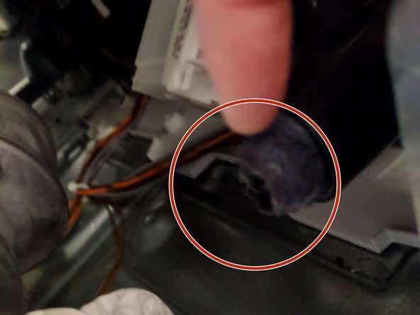

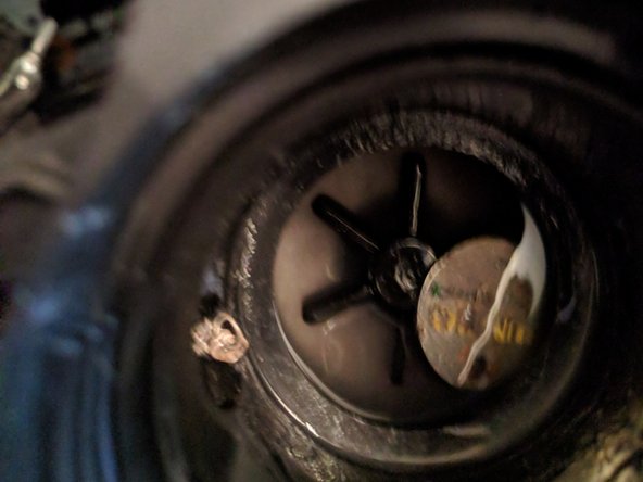

    14. Washing Machine Disassembly to Access Water Drain Pump, Remove debris: step 14, image 1 of 1
      • In my case, the pump inlet (where we just removed the hose coming from the tumbler) was clogged with debris and some cloth.
      • This prevented draining, and even prevented removal of the filter. Thus, requiring disassembly. But we are not done yet.

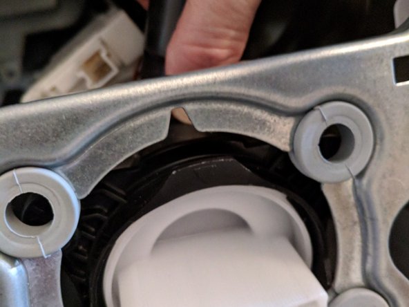

    15. Washing Machine Disassembly to Access Water Drain Pump, Detach filter/pump unit: step 15, image 1 of 3 Washing Machine Disassembly to Access Water Drain Pump, Detach filter/pump unit: step 15, image 2 of 3 Washing Machine Disassembly to Access Water Drain Pump, Detach filter/pump unit: step 15, image 3 of 3
      • Unscrew four T20 screws.
      • Tilt the filter/pump unit (note the tab at the top), and pull it out from the back.

    16. Washing Machine Disassembly to Access Water Drain Pump, Clean inlet, filter, and pump: step 16, image 1 of 3 Washing Machine Disassembly to Access Water Drain Pump, Clean inlet, filter, and pump: step 16, image 2 of 3 Washing Machine Disassembly to Access Water Drain Pump, Clean inlet, filter, and pump: step 16, image 3 of 3
      • At his point you can clean the water inlet, the filter, and the pump. The impeller should move freely. The pump itself can also be removed to replace it (but I did not do that).
      • In my case, a significant amount of cloth got stuck in the water inlet, including a necklace. In the filter, there were some hairpins, and inside the pump itself, a coin and a pendent. LESSON: CLEAN THE FILTER MORE OFTEN, while you can stil remove it without disassembling the machine.
