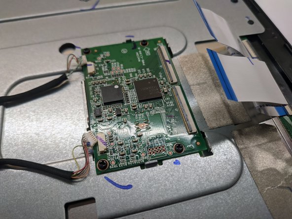

    5. Wacom DTU-1031X Disassembly: step 5, image 1 of 3 Wacom DTU-1031X Disassembly: step 5, image 2 of 3 Wacom DTU-1031X Disassembly: step 5, image 3 of 3
      • To remove the mainboard, unscrew 4 Phillips #00 screws
      • Removal of the yellow kapton tape will be required
      • Unplug the 40-pin LVDS flex cable
      • The transparent tape holding the 40-pin LVDS cable to the mainboard is a part of the cable, and should not be separated
      • Unplug two cables connecting the digitizer daughter board to mainboard
      • Unplug the USB daughter board cable
