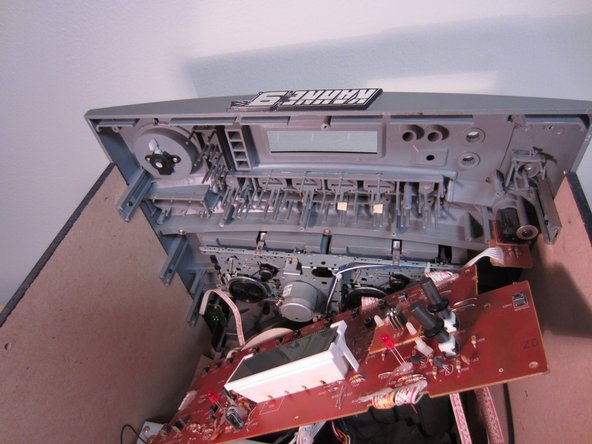

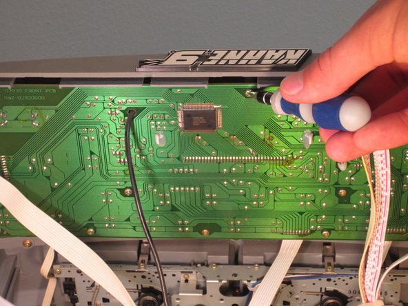

    • Remove the screws that are holding the circuit board in place.
  2. Teac DC-D2831 volume control knob replacement: step 2, image 1 of 2 Teac DC-D2831 volume control knob replacement: step 2, image 2 of 2
    • Pull the circuit board out to reveal the inside of the display.

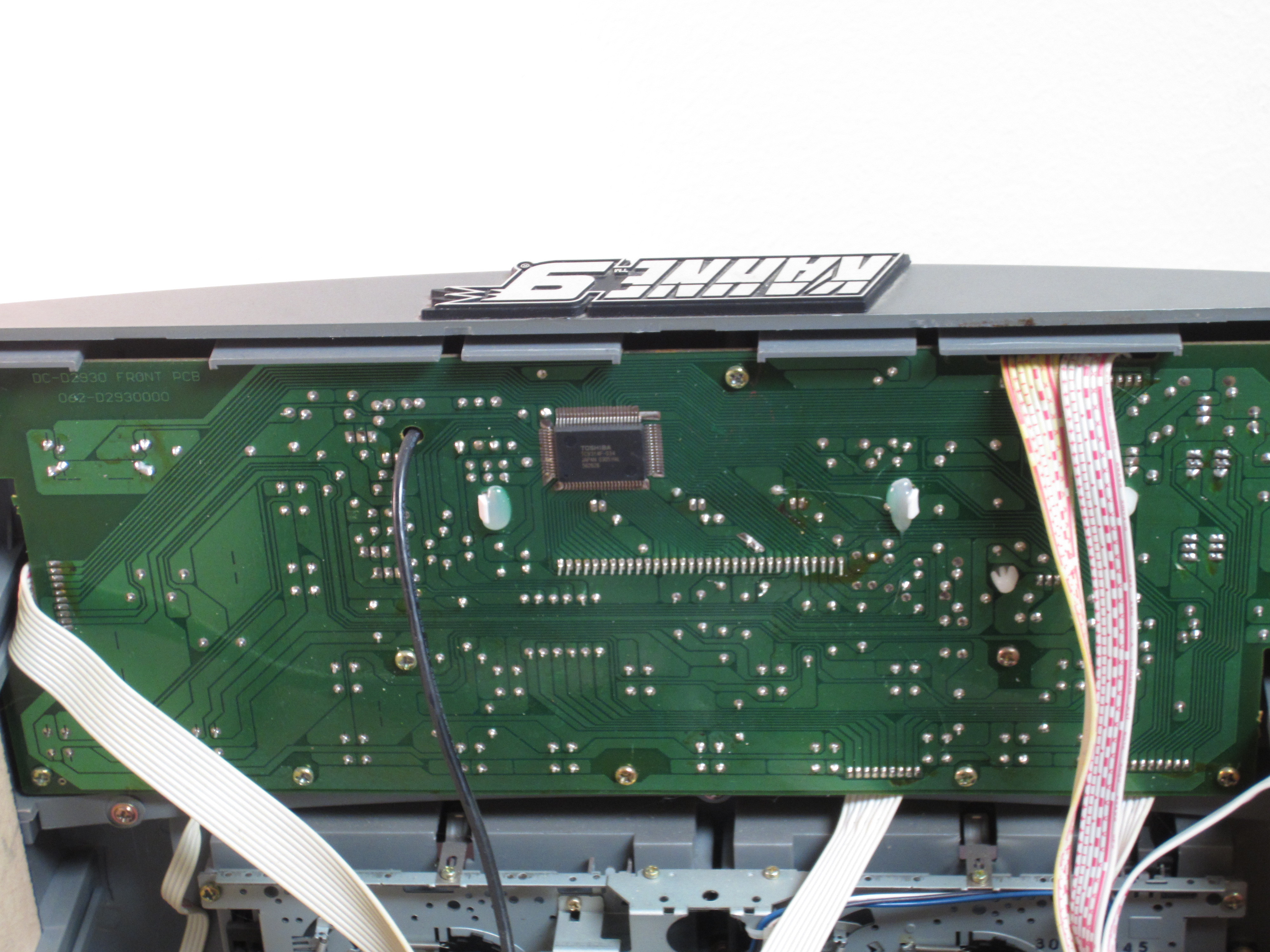

  3. Teac DC-D2831 volume control knob replacement: step 3, image 1 of 3 Teac DC-D2831 volume control knob replacement: step 3, image 2 of 3 Teac DC-D2831 volume control knob replacement: step 3, image 3 of 3
    • Remove the screws and the black piece that are holding the volume control knob in place.

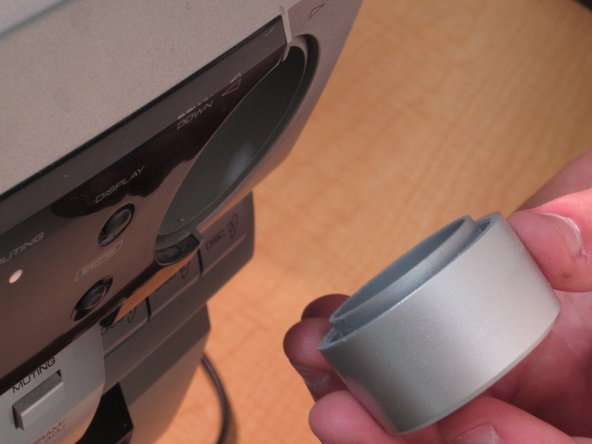

  4. Teac DC-D2831 volume control knob replacement: step 4, image 1 of 2 Teac DC-D2831 volume control knob replacement: step 4, image 2 of 2
    • Pull the volume control knob from the outside and the white piece on the inside until they separate.
    • Replace the volume knob with a new one to complete the repair.
