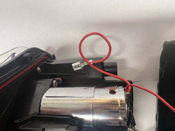

    5. Volt FX-8 Li Switch Replacement, Disconnect battery: step 5, image 1 of 2 Volt FX-8 Li Switch Replacement, Disconnect battery: step 5, image 2 of 2
      • Use long-nose pliers to grip the push-on terminal connecting the red wire to the battery and pull it off of the battery terminal.
      • Tie or tape the lug so it doesn't touch the battery terminal.

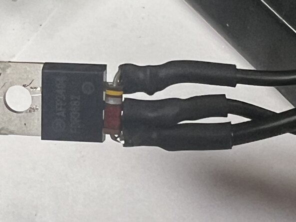

    9. Volt FX-8 Li Switch Replacement, Install resistor on MOSFET: step 9, image 1 of 2 Volt FX-8 Li Switch Replacement, Install resistor on MOSFET: step 9, image 2 of 2
      • Place the resistor against the body of the MOSFET. (This resistor is OLD, yours may look slightly different.)
      • Wrap the resistor leads around the two outside leads of the MOSFET as shown.
      • Cut the resistor leads as shown to leave room for the wire connections.
      • Cut the two outside MOSFET leads as shown.

    10. Volt FX-8 Li Switch Replacement, Connect old switch leads: step 10, image 1 of 2 Volt FX-8 Li Switch Replacement, Connect old switch leads: step 10, image 2 of 2
      • Locate the two old switch leads (Blue in the adjacent wiring diagram).
      • Cut two 1/2" long pieces of 1/8" heat shrink tubing and slide one over each lead.
      • Strip 3/16" of insulation from the end of each lead.
      • Wrap the resistor lead at the source ("S") lead of the MOSFET around the exposed portion of the old switch lead coming from the battery.
      • Solder the connection.
      • Using long-nose pliers, form a hook in the center lead (drain or "D") of the MOSFET. Form the hook around the exposed portion of the old switch lead coming from the motor.

    11. Volt FX-8 Li Switch Replacement, Connect new switch leads: step 11, image 1 of 2 Volt FX-8 Li Switch Replacement, Connect new switch leads: step 11, image 2 of 2
      • Select one of the new switch leads (red in the adjacent wiring diagram).
      • Cut one1/2" long pieces of 1/8" heat shrink tubing and slide it over the lead.
      • Remove the pre-stripped insulation from the end of the lead. Cut the exposed wire to 3/16".
      • Wrap the resistor lead at the gate ("G") lead of the MOSFET around the exposed portion of the new switch lead.
      • Select the other new switch lead (red in the adjacent wiring diagram).
      • Solder the lead to the positive terminal of the motor (alongside the red wire from the battery).

    12. Volt FX-8 Li Switch Replacement, Cover MOSFET connections: step 12, image 1 of 2 Volt FX-8 Li Switch Replacement, Cover MOSFET connections: step 12, image 2 of 2
      • Slide the previously placed pieces of heat shrink tubing over each of the MOSFET terminals.
      • The tubing may snag on protruding stubs of wire. This is usually resolved with a little patience, or in some cases by trimming a protruding stub or re-soldering the wire.
      • Use the butane lighter to shrink the heat shrink tubing. Apply heat to both sides of the assembly to obtain uniform shrinkage.
      • Limit the heating to avoid burning the heat shrink tubing.
      • The entire MOSFET will be covered with the large shrink tubing after testing.

    13. Volt FX-8 Li Switch Replacement, Reconnect battery: step 13, image 1 of 1
      • Turn the switch OFF and position the MOSFET so the metal tab is not touching any metal or wiring.
      • When off, the switch button protrudes from the bushing less than when it is on.
      • Momentarily touch the red wire terminal to the battery terminal.
      • If the motor runs immediately, check for shorts or other problems. A multimeter may be helpful to diagnose problems.
      • If the motor did not run immediately, reconnect the red wire to the battery terminal.

    14. Volt FX-8 Li Switch Replacement, Add heat shrink tubing over MOSFET: step 15, image 1 of 1
      • Cut a 1.5" length of 1/2" diameter heat shrink tubing.
      • Slide the heat shrink tubing over the MOSFET, connections, and small shrink tubing.
      • Use the butane lighter to shrink the tubing.
      • Position the lighter and MOSFET to shrink all sides of the tubing.
