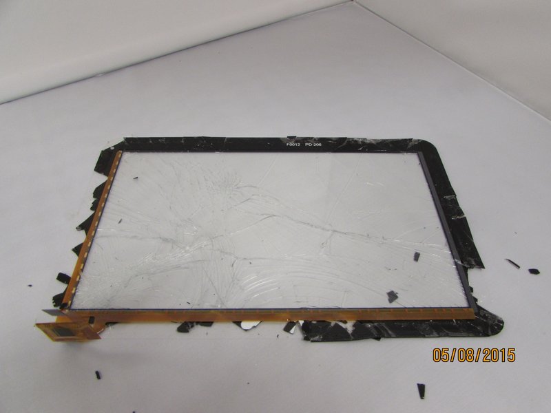

    2. Visual Land Prestige 10 Digitizer Replacement: step 16, image 1 of 3 Visual Land Prestige 10 Digitizer Replacement: step 16, image 2 of 3 Visual Land Prestige 10 Digitizer Replacement: step 16, image 3 of 3
      • Be extremely careful removing the touchscreen, avoiding sharp glass and hot surfaces.
      • Using the heating pad, heat the edges of the touchscreen to loosen the adhesive.
      • using the spudger, slowly and gently work around the edges, removing the touchscreen.
      • The Tablet we used came with a shattered screen, making this step much more difficult.
