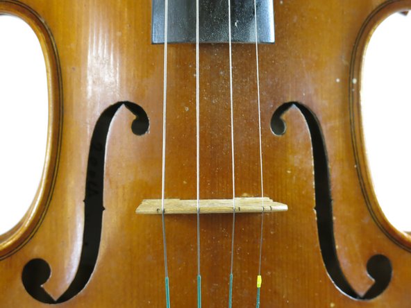

    5. Violin Bridge Replacement: step 5, image 1 of 3 Violin Bridge Replacement: step 5, image 2 of 3 Violin Bridge Replacement: step 5, image 3 of 3
      • Place the new bridge between the center of the f-holes of your violin.
      • f-holes
      • Put the strings on your new bridge, align them with the marks you made in step 4.

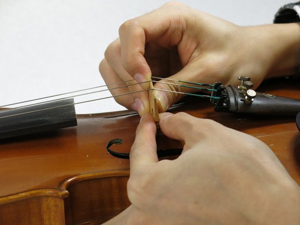

    6. Violin Bridge Replacement: step 6, image 1 of 3 Violin Bridge Replacement: step 6, image 2 of 3 Violin Bridge Replacement: step 6, image 3 of 3
      • Hold the bridge in one hand and tighten the strings in the reverse order you loosened them. That is, tighten the A-string and D-string first, and then, tighten the E-string and G-string. Tighten until each string matches its rough standard pitch (violin tuner suggested).
      • Continue to adjust the bridge to keep it perpendicular to the violin body every time you tighten the string so it is not leaning too far away from the f-holes.
      • After tightening all four strings, play a little to test the string placement. If the distance between the strings is not comfortable for performance (as noted in step 4), repeat step 2-6 and adjust the distance between the strings on the bridge again to find the proper distance.
