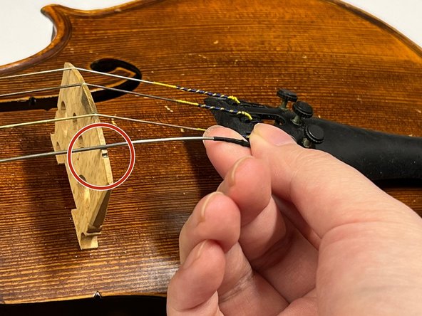

After years of use, viola strings may become worn out or may snap. This guide will show how to replace broken or worn out strings one at a time. Viola strings from left to right are ordered C, G, D, A.

    7. Viola String Replacement: step 7, image 1 of 1
      • Gently tug the newly inserted string to make sure it is secured. If it slides off the bridge, it is not tightened enough.
