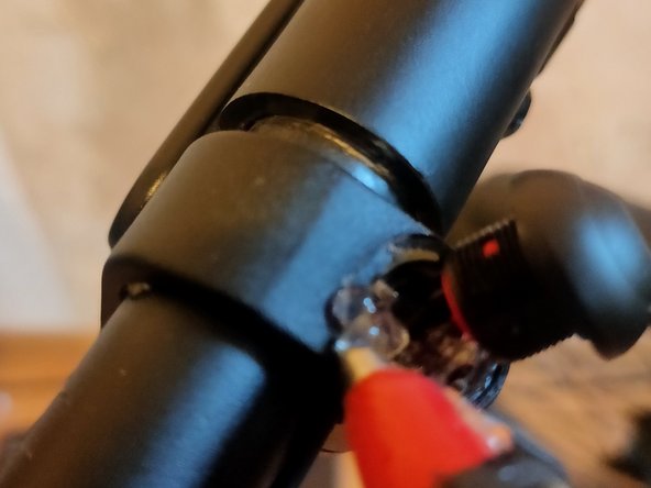

This is the second time one of the buttons stopped working correctly, caused by wetness.
The first time, it was the boost button, followed by an error 41. I took a trip to Amsterdam to get it fixed fast. They shipped my bike back a week later.
This time, it hit the bell button, and it got wet and stuck.
First, I tried to fix it with compressed air and ethanol. It worked for a while, but then it started to double-tap every time it got pushed.
So I could not unlock the bike without a phone.
This time, I wanted to try to fix it myself.
I called for support, and they sent me a replacement cable, telling me that it would be an easy task.
But they have not sent a manual, and I could not find any tutorials online. So I just tried it myself.
Here is the result.
I hope this helps!

      • Get rid of the old button. When you cut it off, the bike can turn on. So: Turn it off.
      • Clean the handlebars of the goo. In my case, it was wet inside.

      • Push the whole break/bell part over the handle. And thread the new cable through the hole, as you can see in the picture.
      • Tie the old cable and the end of the new one together.
      Ask FixBot
    6. VanMoof S3 Bell Button Replacement, red or black?: step 6, image 1 of 3 VanMoof S3 Bell Button Replacement, red or black?: step 6, image 2 of 3 VanMoof S3 Bell Button Replacement, red or black?: step 6, image 3 of 3
      • Unscrew the handlebar with the 5mm hex wrench.
      • Remove the rubber cap located under the handlebars. Remember where you put it.
      • In my case, the bell button was the unmarked cable. Start to pull it to get the new one through. Good luck!

      • If you are unlucky and lose the cable inside. Try to fix it to a wire.
      • You can also try to use the wire to block the path through that hole in the wheel, and push just the cable. It should then bend and appear in the hole.
      • Use the hole and the tweezers to get the cable halfway through.
      • Connect the cables. And try the bell.
