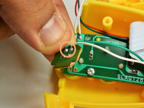

  6. VTech Spin and Learn Color Flashlight Light Bulb Replacement, Light Bulb: step 6, image 1 of 3 VTech Spin and Learn Color Flashlight Light Bulb Replacement, Light Bulb: step 6, image 2 of 3 VTech Spin and Learn Color Flashlight Light Bulb Replacement, Light Bulb: step 6, image 3 of 3
    • Once the main housing is open, locate the light bulb.
    • Remove the light covering from the bulb and take out the light bulb.
    • Desolder the wires from the connection points using the soldering station.
