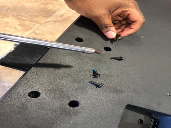

      • Please make sure to unplug the TV or completely remove the plug.
      • Carefully flip the TV over.
      • Start by unscrewing the bottom part of the TV.

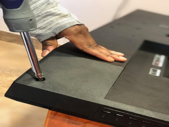

    3. VIZIO TV Screen Replacement: step 3, image 1 of 3 VIZIO TV Screen Replacement: step 3, image 2 of 3 VIZIO TV Screen Replacement: step 3, image 3 of 3
      • Carefully unscrew all of the screws in the back of the TV.

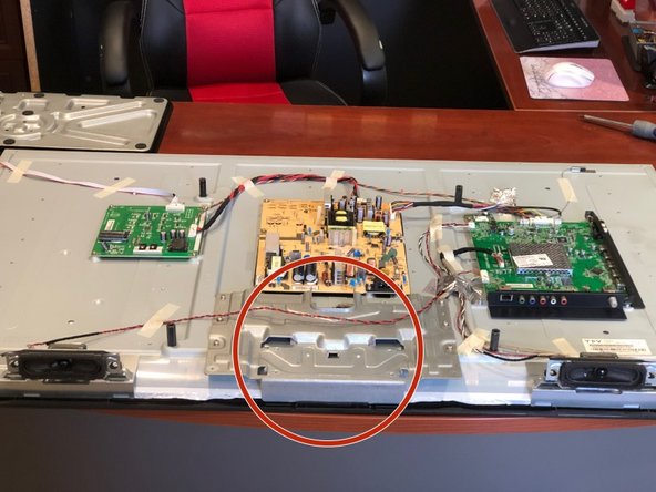

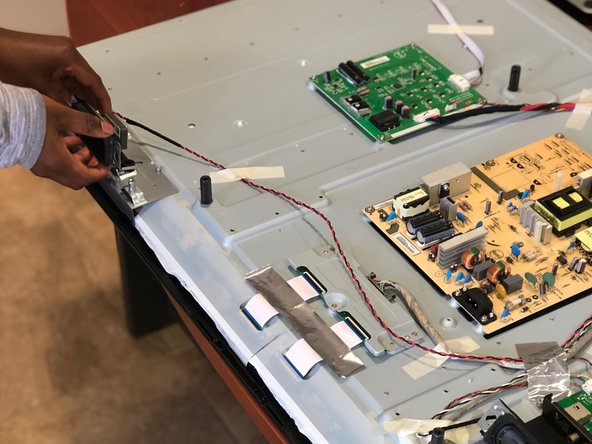

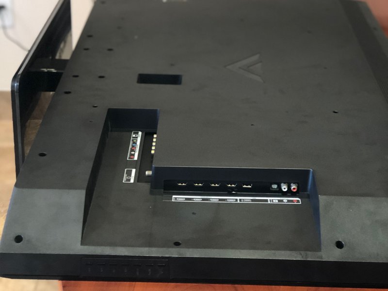

    4. VIZIO TV Screen Replacement: step 4, image 1 of 3 VIZIO TV Screen Replacement: step 4, image 2 of 3 VIZIO TV Screen Replacement: step 4, image 3 of 3
      • Slowly and carefully lift the back of the TV off and put it aside.
      • Next, we study the back of the TV, certain things can be removed and certain things can't. As we go through this guide, I will let you know what can be removed and what cannot. Please use the middle picture as a reference point.
      • The gray metal piece that is stationed underneath the yellowish device is the first thing that we will start to usncrew.
      Ask FixBot

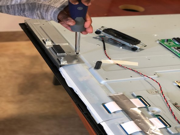

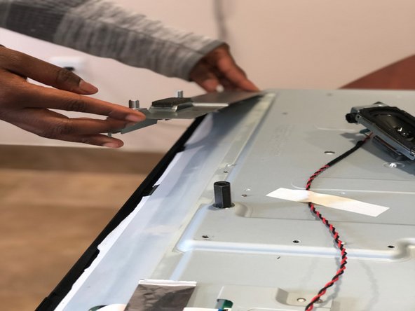

    5. VIZIO TV Screen Replacement: step 5, image 1 of 3 VIZIO TV Screen Replacement: step 5, image 2 of 3 VIZIO TV Screen Replacement: step 5, image 3 of 3
      • Slowly lift up that gray panel and put it aside. Let's move on to the speakers.
      • The speakers are stationed on the side and you can just pull it up, it is magnetic and it can stick on the back of the TV very well. You do not need to unplug anything, you are just removing parts and putting them aside to move the screen.

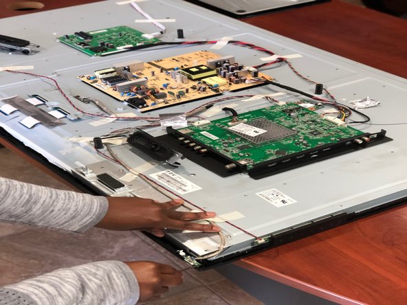

    6. VIZIO TV Screen Replacement: step 6, image 1 of 3 VIZIO TV Screen Replacement: step 6, image 2 of 3 VIZIO TV Screen Replacement: step 6, image 3 of 3
      • Remove the speakers.
      • Do not rip the speakers out. You can potentially pull out an important wire or damage it completely. Be very careful and gentle, set it aside.
      • Next, there is this little chip looking thing at the corner of the TV, take the small screwdriver and put it underneath it and lift it up. Be sure to again be gentle, making sure you don't scratch or chip it.
      Ask FixBot

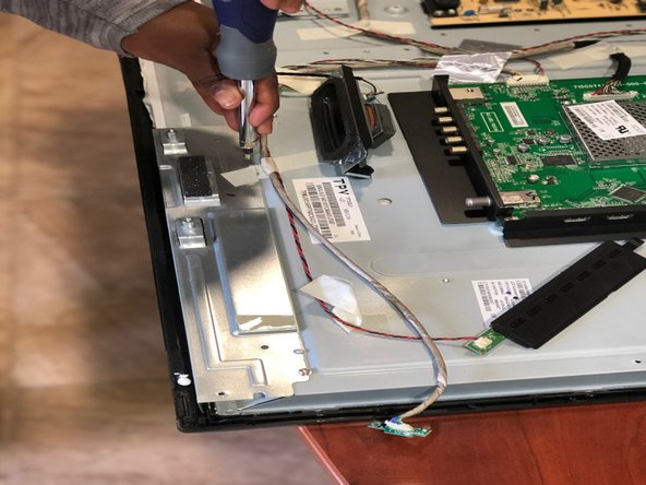

    7. VIZIO TV Screen Replacement: step 7, image 1 of 2 VIZIO TV Screen Replacement: step 7, image 2 of 2
      • After you are done lifting it up, pull it towards you and lift it on top of the TV.
      • If your TV is different than mine, there might be more than one, make sure to find them and if they are connected around the frame, please remove them.
      Ask FixBot

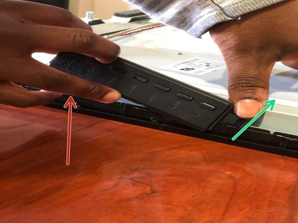

    8. VIZIO TV Screen Replacement, Buttons: step 8, image 1 of 3 VIZIO TV Screen Replacement, Buttons: step 8, image 2 of 3 VIZIO TV Screen Replacement, Buttons: step 8, image 3 of 3
      • Next, we go to the buttons. My thumb is situated on a panel on top of the button, press on it.
      • With your other hand (keeping the thumb pressed on the panel), slowly and carefully lift the button part up.
      • Now, we are moving on to taking out this other medal piece (please see the last picture in this step).

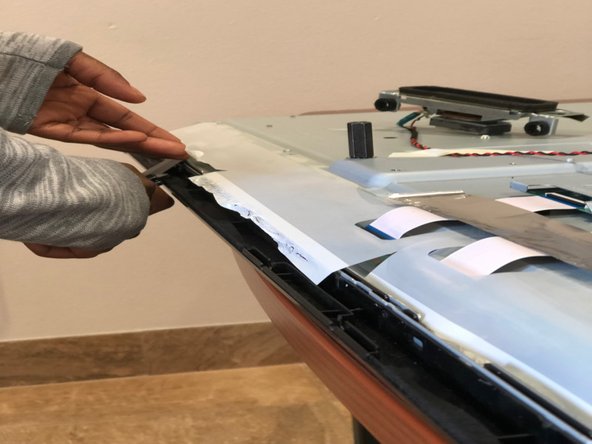

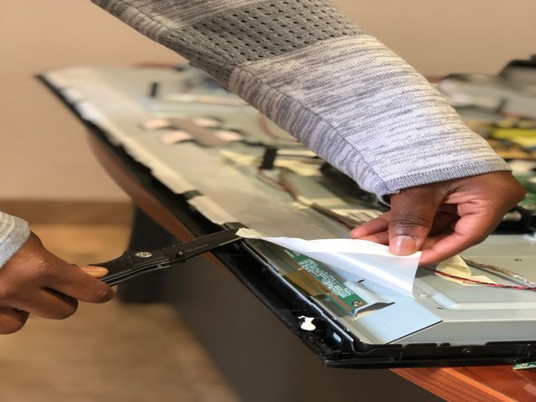

    10. VIZIO TV Screen Replacement, Sticky film: step 10, image 1 of 3 VIZIO TV Screen Replacement, Sticky film: step 10, image 2 of 3 VIZIO TV Screen Replacement, Sticky film: step 10, image 3 of 3
      • There is this little sticker plastic thing that is located at the bottom. We are going to now use our pocket knife, the back part of it because we do not want to cut or rip that plastic section.
      • The tip of the knife should be used to help peel it and then the back of it should help lift it up.
      • It's okay, this is super sticky, so it will re-stick when you put it back together. Once done, go ahead and tuck it up (see last photo in this step) and move on to the next step.
      Ask FixBot

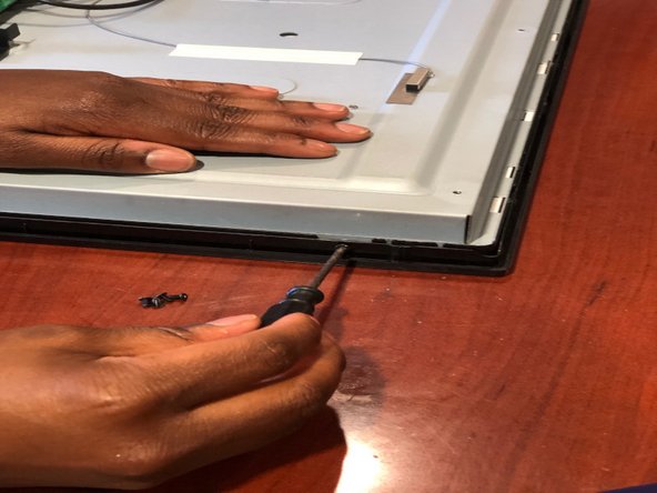

    11. VIZIO TV Screen Replacement, Tiny Screws: step 11, image 1 of 3 VIZIO TV Screen Replacement, Tiny Screws: step 11, image 2 of 3 VIZIO TV Screen Replacement, Tiny Screws: step 11, image 3 of 3
      • Here is where it gets a bit complicated. There is a lot of tiny little screws around the edge of the TV. Unscrew them going around and putting them aside.
      • Make sure to get every little screw, because when we flip the TV (super heavy!) we are going to remove the frame and if one screw is in there, it will be super difficult to remove.
      • Once you get all of the screws, go back and make sure you didn't leave one so we can do one quick flip and done. :)

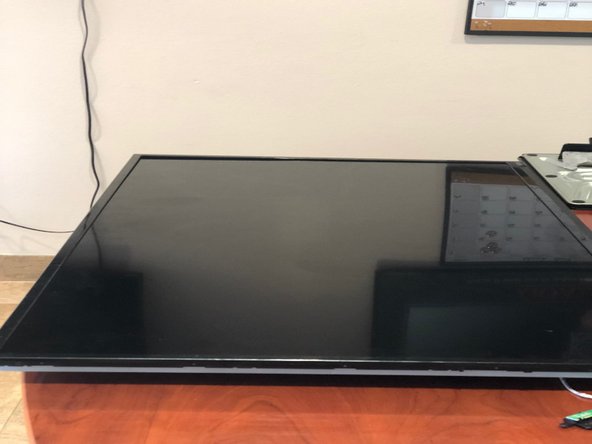

    12. VIZIO TV Screen Replacement, Let's flip it... again!: step 12, image 1 of 3 VIZIO TV Screen Replacement, Let's flip it... again!: step 12, image 2 of 3 VIZIO TV Screen Replacement, Let's flip it... again!: step 12, image 3 of 3
      • Now, again at the bottom, unclip the frame from the metal part. Make sure to do it carefully so that the plastic doesn't break.
      • Once done, flip the TV. It should look like the next two pictures.

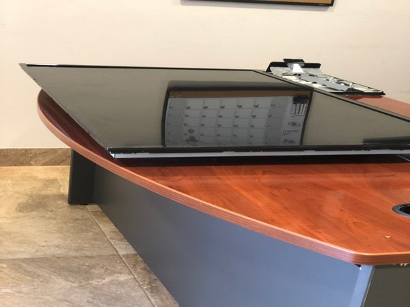

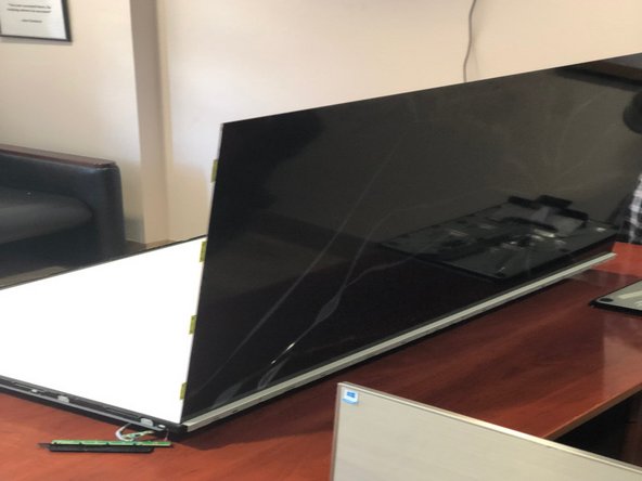

    13. VIZIO TV Screen Replacement, Screen removal: step 13, image 1 of 3 VIZIO TV Screen Replacement, Screen removal: step 13, image 2 of 3 VIZIO TV Screen Replacement, Screen removal: step 13, image 3 of 3
      • Next, we lift up the frame from in front of the TV (those tiny side screws did the work) and set it aside.
      • Once done, lift up the glass section (carefully, it is glass) and replace it with a brand new glass screen!
      • Make sure to match the right glass with the right TV, some of the glass can be a bit pricey (around $100 to $150) , but not as pricey as when someone else does it for you.
      • This is the end of this guide book!
