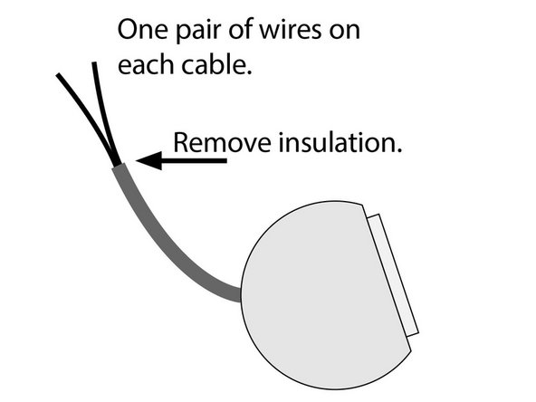

    3. Using Apple Pro Speakers with a class-d amplifier: step 3, image 1 of 1
      • Remove the outer insulation on each speaker cable. Remove up to two inch of isolation. You can use a scissor or a wire stripper. Be ultra careful not to damage or cut the inner wires.
      • Two wires are inside each speaker cable.

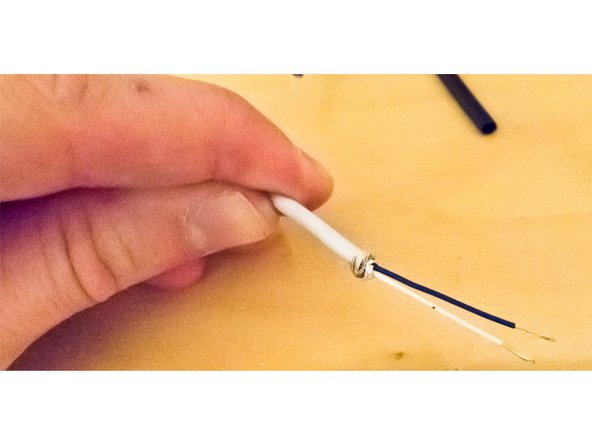

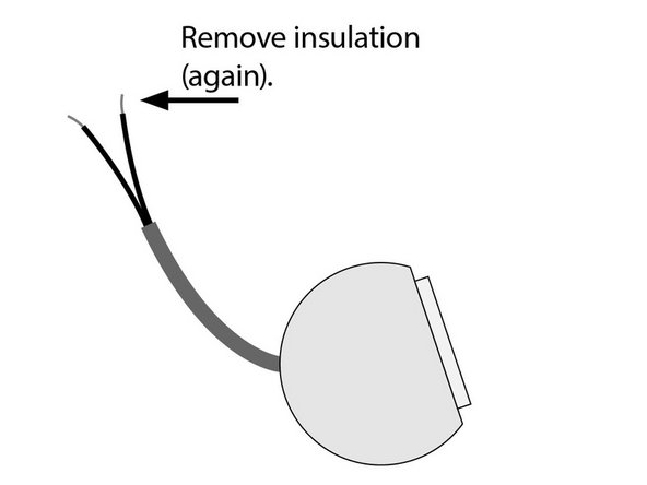

    4. Using Apple Pro Speakers with a class-d amplifier: step 4, image 1 of 1
      • Now also remove the insulation of the small inner wires. Again be careful not to cut the cables as they are very small.

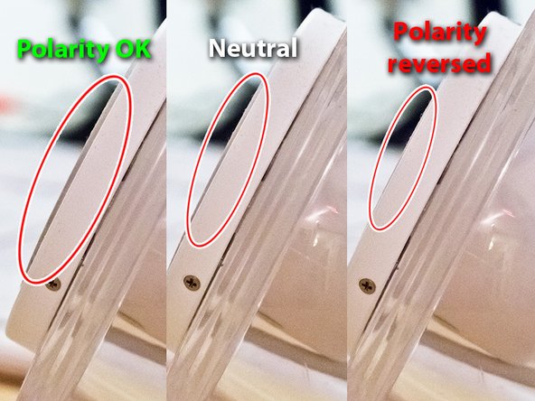

    7. Using Apple Pro Speakers with a class-d amplifier: step 7, image 1 of 1
      • Now connect one wire to the negative terminal (-) and the other to the positive terminal (+) of the AA battery.
      • If the speaker cone bulges out (left image), you've got the proper polarity. You now know that the wire on the positive terminal of the AA battery is your "+" wire, i.e. it will connect with the "+" output of your amp.
      • If the speaker cone moves in (right image), the polarity is reversed. You now know that the wire on the negative terminal of the AA battery would be your "+" wire, i.e. it will connect with the "+" output of your amp.

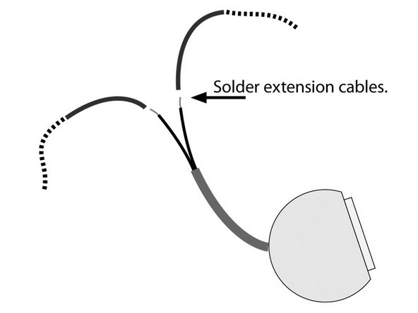

    8. Using Apple Pro Speakers with a class-d amplifier: step 8, image 1 of 1
      • Now solder an extension cable to each of the stripped wires. If you want you can use a red wire for positive (+) and a black wire for negative (-) so you can easily connect the speakers with the amp later.

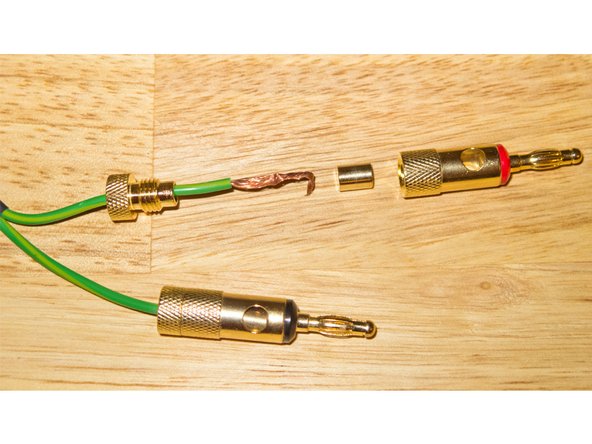

    10. Using Apple Pro Speakers with a class-d amplifier: step 10, image 1 of 1
      • Now strip the extension cables of each speaker. You are now ready to connect the speakers to your amp.
      • If you like you can use banana plugs with the stripped cables (like seen in the image).
