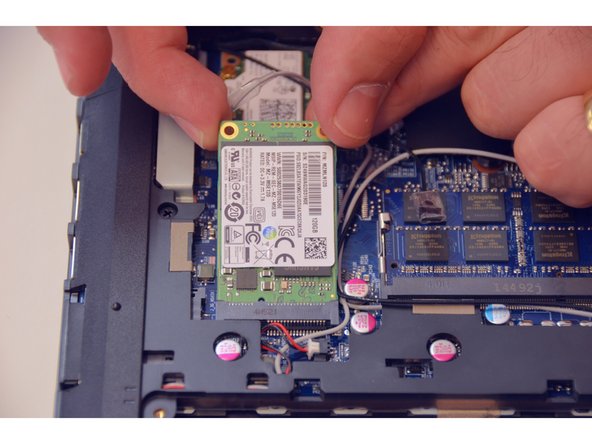

    1. Upgrading the SSD, PCIe SSD: step 4, image 1 of 3 Upgrading the SSD, PCIe SSD: step 4, image 2 of 3 Upgrading the SSD, PCIe SSD: step 4, image 3 of 3
      • This is where you'll find the PCIe SSD.
      • Remove the fastening screw with the Philips-head screwdriver.
      • Remove the PCIe SSD.

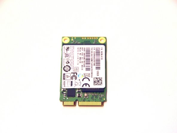

    2. Upgrading the SSD: step 5, image 1 of 1
      • This is what the PCIe SSD looks like.
