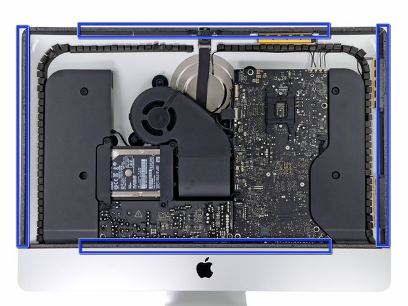

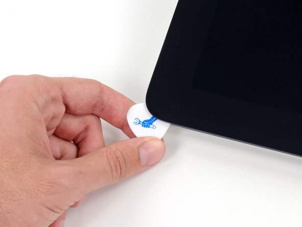

  1. Upgrading iMac Intel 21.5" EMC 2544 RAM Memory, Unglue the screen: step 1, image 1 of 1

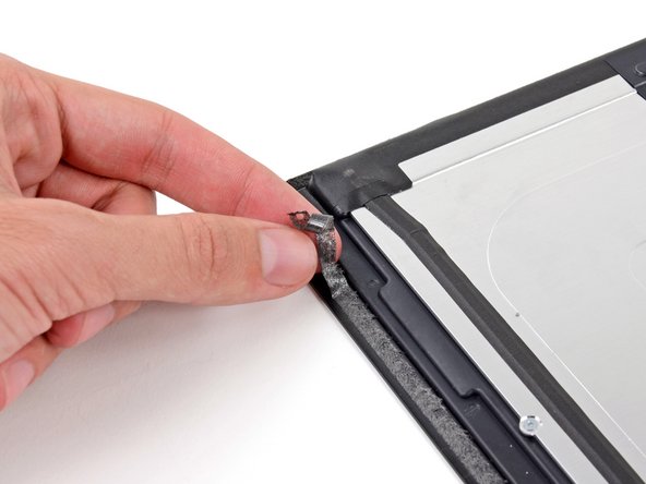

    • First you need to remove the glue from the edge of the iMac
    • Use a Guitar Pick around the screen to remove the glue
    • Be careful not to damage the iSight camera

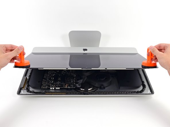

  2. Upgrading iMac Intel 21.5" EMC 2544 RAM Memory, Screen: step 2, image 1 of 2 Upgrading iMac Intel 21.5" EMC 2544 RAM Memory, Screen: step 2, image 2 of 2
    • Once you are sure the adhesive is removed, use two heavy suction cups to lift the screen
    • Unplug these cables:
    • DisplayPort Cable
    • Power Cable
    • Lift the screen from the iMac

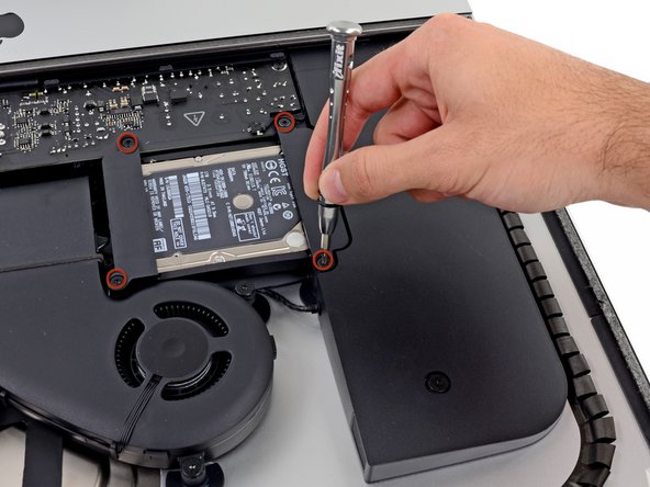

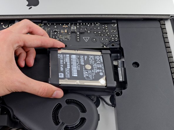

  4. Upgrading iMac Intel 21.5" EMC 2544 RAM Memory, Hard drive: step 4, image 1 of 2 Upgrading iMac Intel 21.5" EMC 2544 RAM Memory, Hard drive: step 4, image 2 of 2
    • Remove the four Torx T10 screws
    • Unplug the SATA cables and remove the hard drive

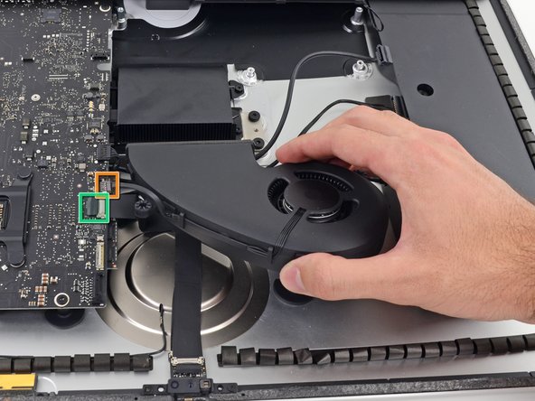

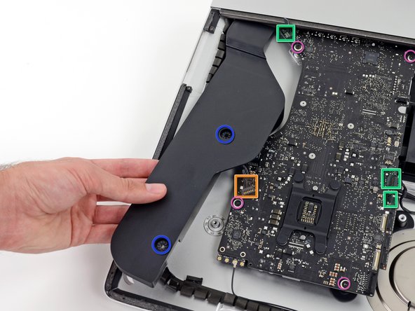

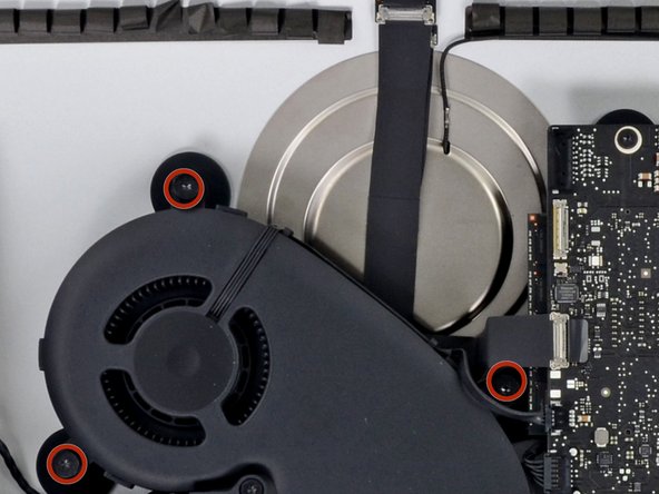

  5. Upgrading iMac Intel 21.5" EMC 2544 RAM Memory, Fan: step 5, image 1 of 2 Upgrading iMac Intel 21.5" EMC 2544 RAM Memory, Fan: step 5, image 2 of 2
    • Remove these 3 Torx T10 screws
    • After you remove the screws, remove these cables
    • Fan Cable
    • Unstick and unplug the camera cable
    • After you remove the fan, remove the hard drive bay removing a single Torx T10 screw

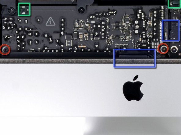

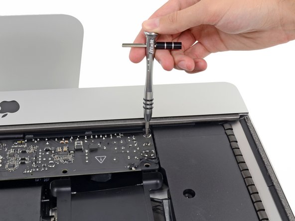

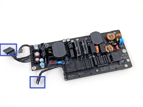

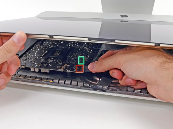

  6. Upgrading iMac Intel 21.5" EMC 2544 RAM Memory, Power board: step 6, image 1 of 3 Upgrading iMac Intel 21.5" EMC 2544 RAM Memory, Power board: step 6, image 2 of 3 Upgrading iMac Intel 21.5" EMC 2544 RAM Memory, Power board: step 6, image 3 of 3
    • Remove these 2 Torx T10 screws
    • Unplug these 2 cables
    • Unplug 2 more cable below the power board by pressing the clip
    • The power board is hard to remove from its place, remove it carefully

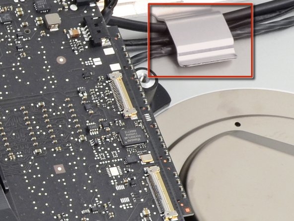

  7. Upgrading iMac Intel 21.5" EMC 2544 RAM Memory: step 7, image 1 of 1
    • Remove the cables out of the clip

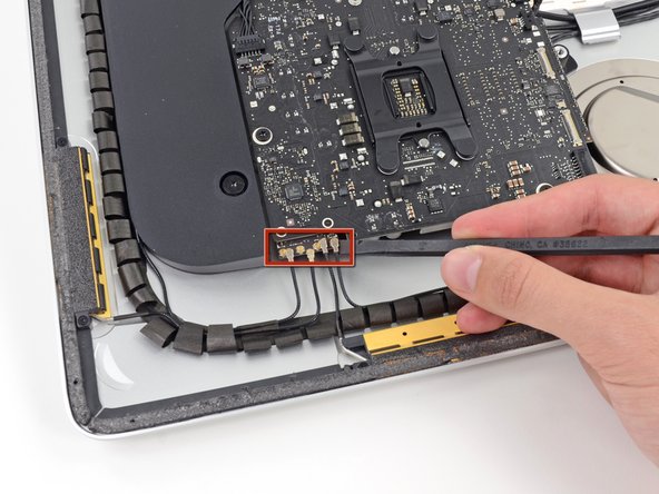

  8. Upgrading iMac Intel 21.5" EMC 2544 RAM Memory: step 8, image 1 of 2 Upgrading iMac Intel 21.5" EMC 2544 RAM Memory: step 8, image 2 of 2
    • Unplug these 4 antenna connectors
    • When reassembling be sure that the connectors are in the same place
    • After that, remove these two Torx T10 screws
    • Move the speaker and unplug the cable from the logic board
    • Remove these other cables
    • For finish, remove these four Torx T10 screws

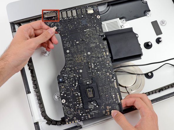

  9. Upgrading iMac Intel 21.5" EMC 2544 RAM Memory, Logic Board: step 9, image 1 of 2 Upgrading iMac Intel 21.5" EMC 2544 RAM Memory, Logic Board: step 9, image 2 of 2
    • Unscrew 3 Torx T8 screws from the heatsink, then remove the logic board from the iMac
    • Be careful not to damage the SD card reader with the screw mount

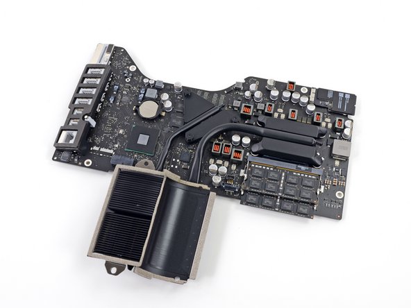

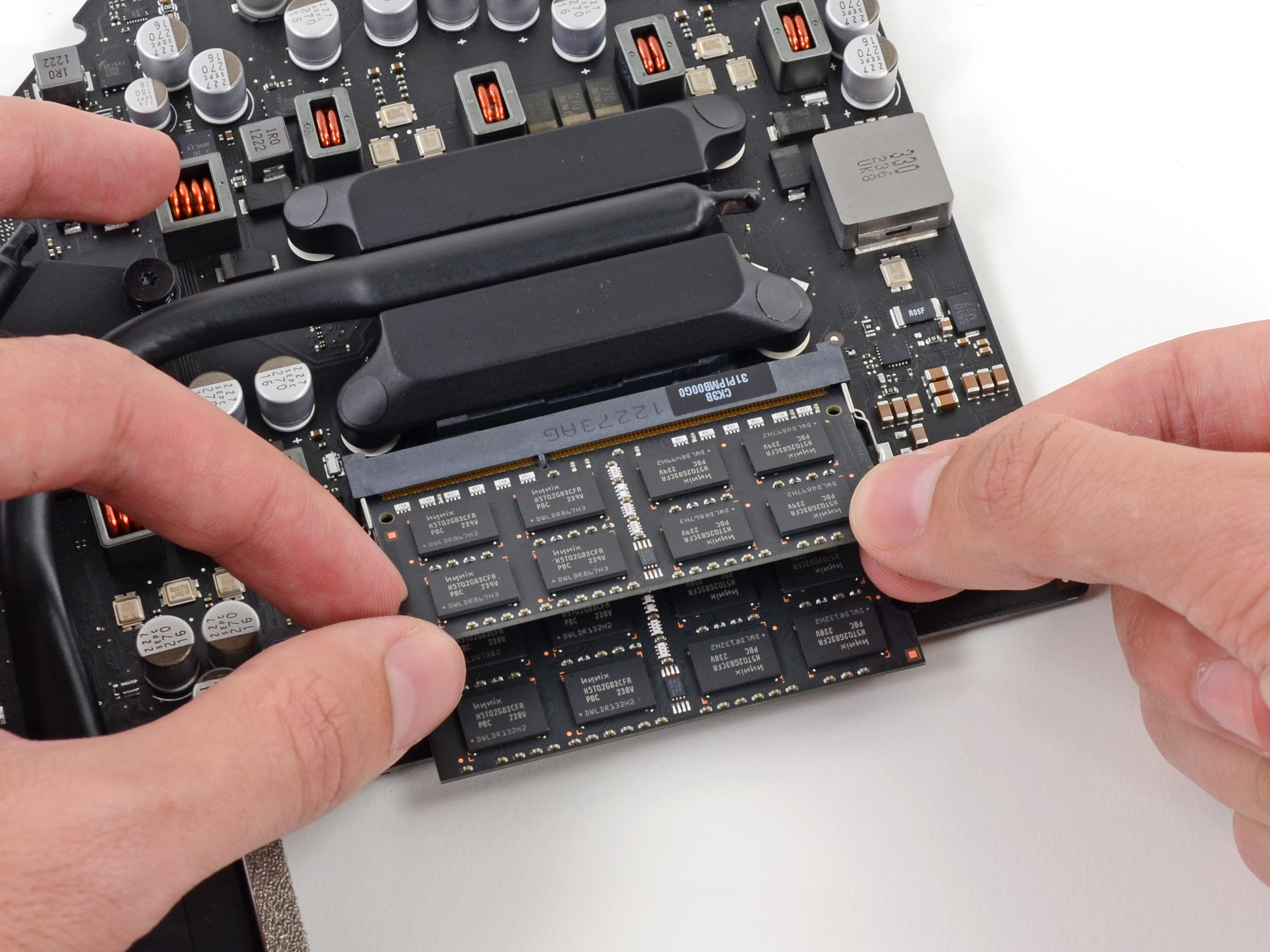

  10. Upgrading iMac Intel 21.5" EMC 2544 RAM Memory, RAM memory: step 10, image 1 of 2 Upgrading iMac Intel 21.5" EMC 2544 RAM Memory, RAM memory: step 10, image 2 of 2
    • Flip the logic board over and release the tabs from each side of the RAM
To reassemble your device, follow these instructions in reverse order remembering to re-glue the screen.
