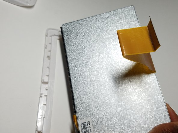

      • Lift off the black clip connecting the first power ribbon to the motherboard
      • Undo the clips off the second power ribbon connecting the screen to the motherboard.

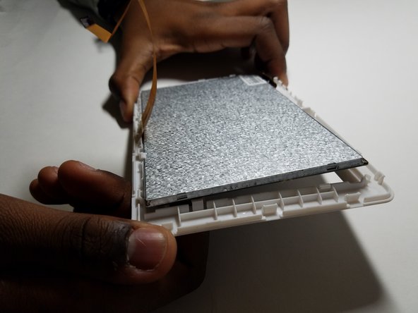

      • Slowly remove the screen component off the tablet by clipping the screen from the tablet outine
      • Do not apply too much pressure on the tablet casing.
