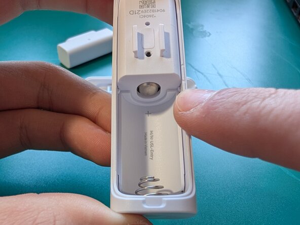

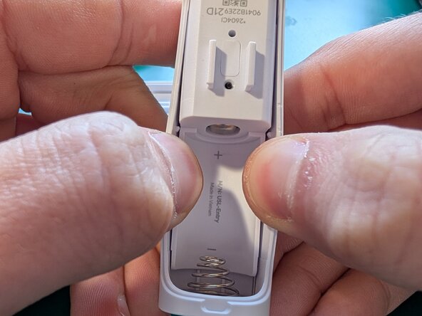

    1. Ubiquiti Unifi Entry Sensor | USL-Entry, Battery Cover: step 1, image 1 of 3 Ubiquiti Unifi Entry Sensor | USL-Entry, Battery Cover: step 1, image 2 of 3 Ubiquiti Unifi Entry Sensor | USL-Entry, Battery Cover: step 1, image 3 of 3
      • Begin by removing the battery cover. Use the included tool to pop off the edge, then pry outwards to disconnect the large plastic clips that are further down.
