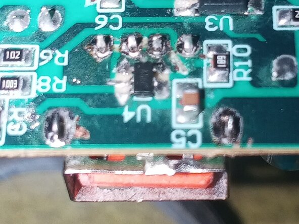

      • If you are starting on the electronic board, we can see the label USB here; we will place the new USB port or the spare part from another board here.

      • On the back with a mesh, we will remove the solder where the USB port pins enter.

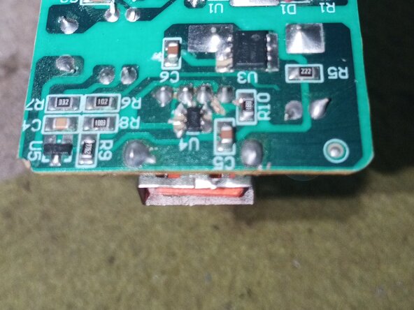

    3. USB Port Replacement: step 3, image 1 of 1
      • Once the solder is removed with the desoldering wick or a solder sucker, proceed to install your USB port.
