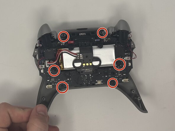

    4. Turtle Beach Stealth Ultra Option Buttons Replacement: step 9, image 1 of 2 Turtle Beach Stealth Ultra Option Buttons Replacement: step 9, image 2 of 2
      • Remove the six 10 mm screws connected to the motherboard using a Phillips #00 screwdriver.

    5. Turtle Beach Stealth Ultra Option Buttons Replacement: step 10, image 1 of 1
      • Gently pull the motherboard away from the frame.
