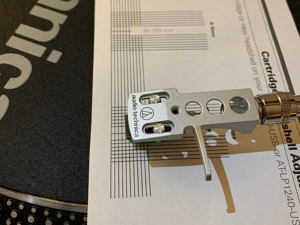

    6. Turntable Needle Replacement and Calibration: step 6, image 1 of 3 Turntable Needle Replacement and Calibration: step 6, image 2 of 3 Turntable Needle Replacement and Calibration: step 6, image 3 of 3
      • Place the stylus on the dot in the center of the "A lines", furthest away from the center of the record.
      • Check to see if the edge of stylus cartridge is aligned with the "B lines" on the protractor.
      • When the edge of the stylus cartridge is not aligned with the "B lines" on the protractor, this means it is out of alignment and needs to be calibrated. To begin, make sure that the tonearm is in the lifted position, by lifting the tonearm lever.
      Ask FixBot
    7. Turntable Needle Replacement and Calibration: step 7, image 1 of 3 Turntable Needle Replacement and Calibration: step 7, image 2 of 3 Turntable Needle Replacement and Calibration: step 7, image 3 of 3
      • Hold the cartridge in place, and use the screwdriver to unscrew the screws on top of the cartridge.
      • Once the cartridge is loose, slide the screws and check alignment to see if the stylus box lines up with the "B lines".
      • Once the cartridge lines up with the "B lines", use the screwdriver to secure the screws in place.
