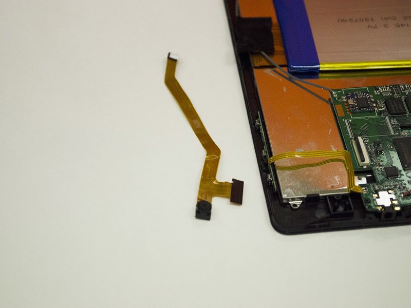

    3. Trio STEALTH-9 Camera Replacement: step 7, image 1 of 2 Trio STEALTH-9 Camera Replacement: step 7, image 2 of 2
      • Detach the Camera's ribbon cable from the Motherboard using your fingernail or a plastic opening tool.
      • Remove the camera from the frame and replace as needed.
      Ask FixBot
