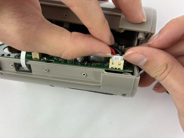

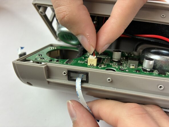

    8. Treblab HD77 Battery Replacement: step 13, image 1 of 3 Treblab HD77 Battery Replacement: step 13, image 2 of 3 Treblab HD77 Battery Replacement: step 13, image 3 of 3
      • Orient the speaker so the motherboard is on the bottom half, facing up, and the circuit board cutout is facing you.
      • Using your thumb and pointer finger, grip the plug connected to the large red and black wires just below the extruded tip, and gently lift until the plug comes out.
      Ask FixBot
    9. Treblab HD77 Battery Replacement: step 14, image 1 of 3 Treblab HD77 Battery Replacement: step 14, image 2 of 3 Treblab HD77 Battery Replacement: step 14, image 3 of 3
      • Using your thumb and pointer finger, grip the plug connected to the smaller red and black wires just below the extruded tip, and gently lift until the plug comes out.
      Ask FixBot
    10. Treblab HD77 Battery Replacement: step 15, image 1 of 3 Treblab HD77 Battery Replacement: step 15, image 2 of 3 Treblab HD77 Battery Replacement: step 15, image 3 of 3
      • The battery is located on the half without the motherboard and has a layer of foam surrounding it.
      • Lift the battery out of the shell using your thumb on the edge of the battery.
