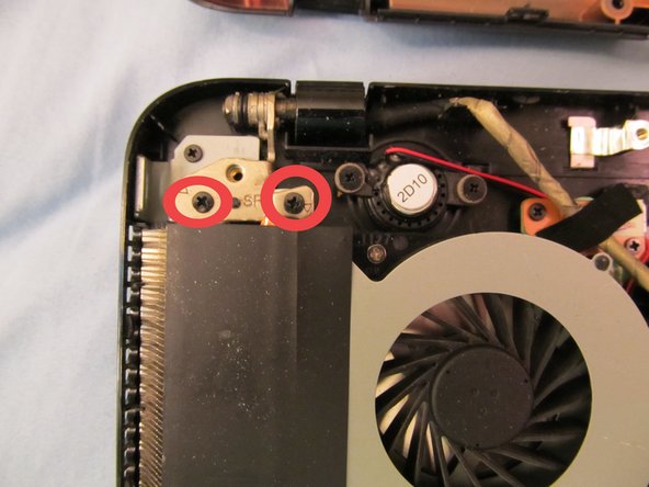

    • Two screws on each hinge await for your removal.
    • Note the screw organizer. This is how many screws we've removed. (The one with an arrow pointing to it we did NOT remove in this tutorial. It is located under the DVD drive after the drive is removed. It is not necessary to remove it)

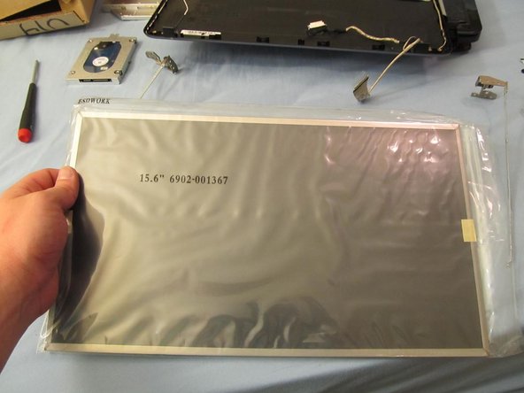

  23. Toshiba Satellite L855-S5210 LCD Screen Replacement: step 23, image 1 of 3 Toshiba Satellite L855-S5210 LCD Screen Replacement: step 23, image 2 of 3 Toshiba Satellite L855-S5210 LCD Screen Replacement: step 23, image 3 of 3
    • Check out your screw collection. This is roughly what yours should look like if you're keeping track of them.
    • Finally, bust out your new LCD screen that you should have purchased from www.laptopscreen.com, and reverse the entire procedure for installation.
    • -- Final Notes and Credits: Difficulty Level: Medium. | Screen purchased from: www.laptopscreen.com (their email support will land you a compatible screen within hours!) | We are The PC Penguin, www.thepcpenguin.com
