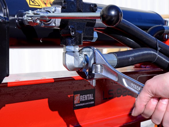

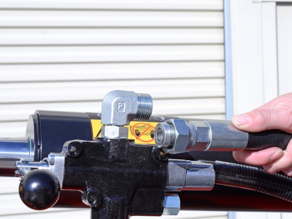

  8. Toro Log Splitters 22618HD 2019 Control Valve Replacement, Remove the output hose: step 8, image 1 of 2 Toro Log Splitters 22618HD 2019 Control Valve Replacement, Remove the output hose: step 8, image 2 of 2
    • Use an adjustable wrench to loosen the nut securing the output hose to the L-fitting on top of the control valve.
  9. Toro Log Splitters 22618HD 2019 Control Valve Replacement: step 9, image 1 of 2 Toro Log Splitters 22618HD 2019 Control Valve Replacement: step 9, image 2 of 2
    • Remove the output hose from the top L-fitting.

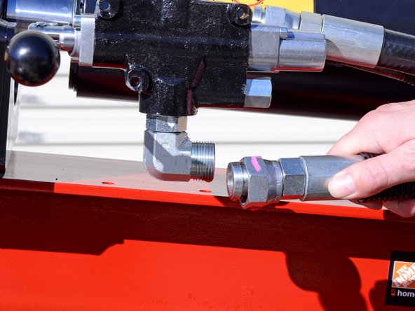

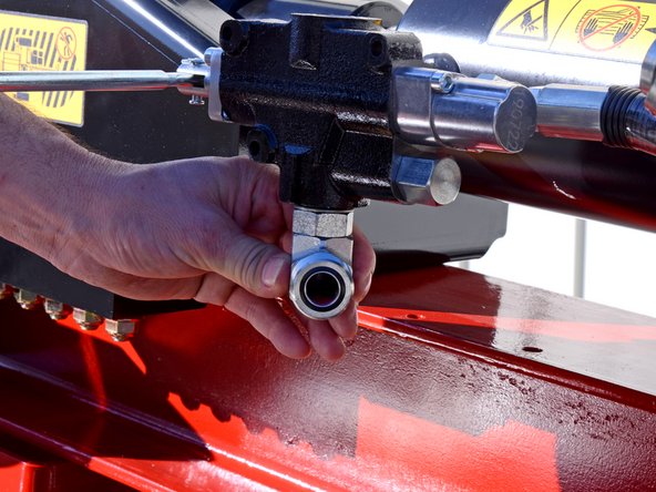

  10. Toro Log Splitters 22618HD 2019 Control Valve Replacement, Remove the input hose: step 10, image 1 of 2 Toro Log Splitters 22618HD 2019 Control Valve Replacement, Remove the input hose: step 10, image 2 of 2
    • Use an adjustable wrench to loosen the nut holding the input hose to the L-fitting on the bottom of the control valve.
  11. Toro Log Splitters 22618HD 2019 Control Valve Replacement: step 11, image 1 of 2 Toro Log Splitters 22618HD 2019 Control Valve Replacement: step 11, image 2 of 2
    • Remove the input hose from the bottom L-fitting.

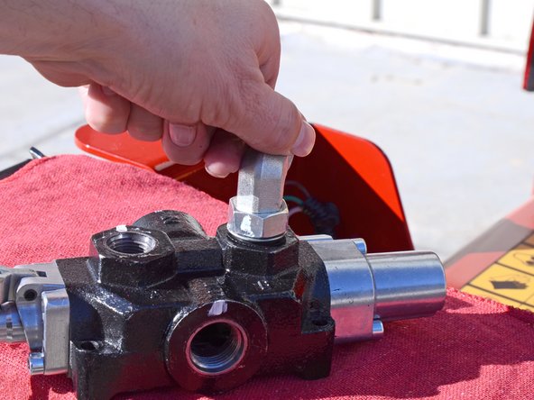

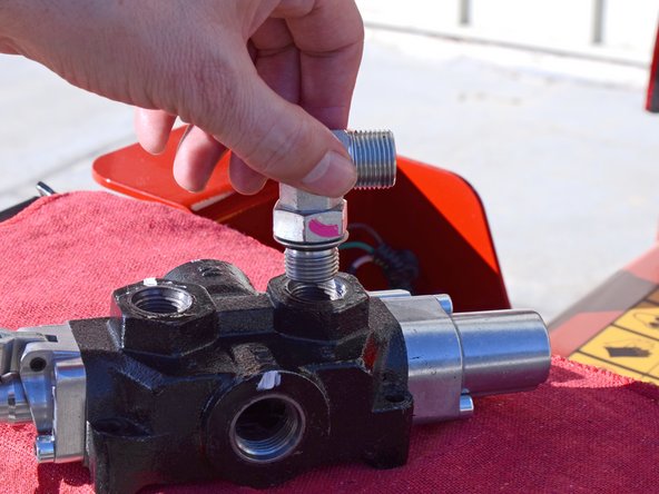

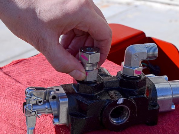

  12. Toro Log Splitters 22618HD 2019 Control Valve Replacement, Remove the top L-fitting: step 12, image 1 of 1
    • Use an adjustable wrench to loosen the nut securing the top L-fitting to the control valve.
  13. Toro Log Splitters 22618HD 2019 Control Valve Replacement: step 13, image 1 of 3 Toro Log Splitters 22618HD 2019 Control Valve Replacement: step 13, image 2 of 3 Toro Log Splitters 22618HD 2019 Control Valve Replacement: step 13, image 3 of 3
    • Spin the top L-fitting counter-clockwise to remove it.
    • This fitting is part number 340-16.

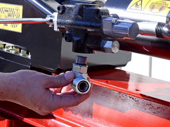

  14. Toro Log Splitters 22618HD 2019 Control Valve Replacement, Remove the bottom L-fitting: step 14, image 1 of 1
    • Use an adjustable wrench to loosen the nut securing the bottom L-fitting to the control valve.
  15. Toro Log Splitters 22618HD 2019 Control Valve Replacement: step 15, image 1 of 3 Toro Log Splitters 22618HD 2019 Control Valve Replacement: step 15, image 2 of 3 Toro Log Splitters 22618HD 2019 Control Valve Replacement: step 15, image 3 of 3
    • Remove the bottom L-fitting.

  20. Toro Log Splitters 22618HD 2019 Control Valve Replacement, Remove leftover fittings: step 20, image 1 of 1
    • Use an adjustable wrench to loosen the nut securing the piston contraction fitting to the control valve.
  21. Toro Log Splitters 22618HD 2019 Control Valve Replacement: step 21, image 1 of 3 Toro Log Splitters 22618HD 2019 Control Valve Replacement: step 21, image 2 of 3 Toro Log Splitters 22618HD 2019 Control Valve Replacement: step 21, image 3 of 3
    • Spin the piston contraction fitting counter-clockwise to remove it.
    • This fitting is part number 100-7671.
