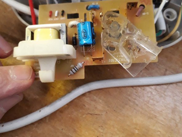

    1. Toaster lever does not lock, Capacitor in the power supply: step 1, image 1 of 2 Toaster lever does not lock, Capacitor in the power supply: step 1, image 2 of 2
      • Remove both retainers. You may need to pull with considerable force.
      Ask FixBot
    2. Toaster lever does not lock: step 2, image 1 of 1
      • Remove the screws on the underside (no images) and flip the housing to the side over both handle holders.
      Ask FixBot
    3. Toaster lever does not lock: step 3, image 1 of 1
      • Lift the circuit board out of its holder. Desolder the electrolytic capacitor and replace it with a new one (470µF, 50V).
      Ask FixBot
