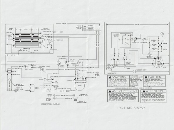

Timer Only Advances in Timed Dry Mode
    1. Timer Only Advances in Timed Dry Mode, Clean lint from exhaust tube, outdoor vent, and tube inside dryer.: step 1, image 1 of 2 Timer Only Advances in Timed Dry Mode, Clean lint from exhaust tube, outdoor vent, and tube inside dryer.: step 1, image 2 of 2
      • All I did to make this machine start working again was clean out all the lint. Likely what happened is that the exhaust flow was restricted, so the high-limit switch was being tripped (at drum inlet) but couldn't heat the clothes enough to dry them or trip the cycling thermostat switch (at drum outlet).
