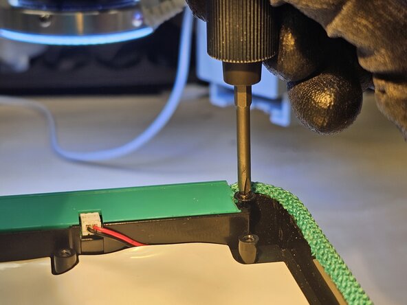

    1. Tigerbox 1203 USB-C Port Repair, Replacing the USB-C port: step 1, image 1 of 3 Tigerbox 1203 USB-C Port Repair, Replacing the USB-C port: step 1, image 2 of 3 Tigerbox 1203 USB-C Port Repair, Replacing the USB-C port: step 1, image 3 of 3
      • We start at the bottom of the Tigerbox and loosen the five Phillips-head screws using a suitable PH00 screwdriver
