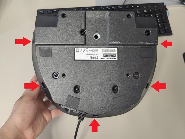

    1. Thrustmaster T300 Fan replacement, Base opening: step 1, image 1 of 3 Thrustmaster T300 Fan replacement, Base opening: step 1, image 2 of 3 Thrustmaster T300 Fan replacement, Base opening: step 1, image 3 of 3
      • Unscrew the 4 screws on the front panel.
      • Unscrew the 3 screws under the cover.
      • Unscrew the 5 screws under the base.
      • Take off the top cover from your base by lifting it from the back.

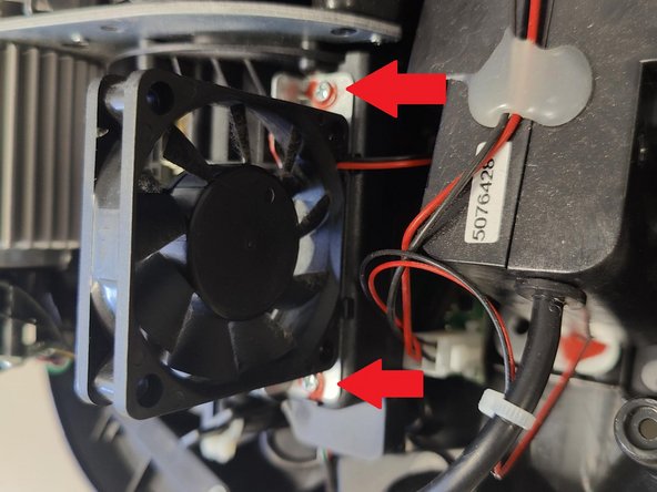

    2. Thrustmaster T300 Fan replacement, Fan replacement: step 2, image 1 of 2 Thrustmaster T300 Fan replacement, Fan replacement: step 2, image 2 of 2
      • Disconnect the fan connector from the main PCB.
      • Remove the fan by unscrew 2 screws of the fan.
      Ask FixBot
To reassemble your unit, follow the instructions in reverse order.
