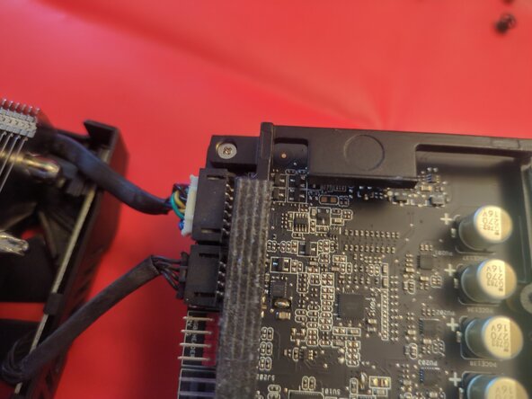

    3. Thermal Pad Replacement: step 3, image 1 of 3 Thermal Pad Replacement: step 3, image 2 of 3 Thermal Pad Replacement: step 3, image 3 of 3
      • Gently lift the GPU and its backplate off the heatsink.
      • If the thermal paste on the GPU die is gluing it to the heatsink, warm it up a bit. Or carefully wiggle it side to side until it loosens.
      • Unplug the two cables holding the halves together.
