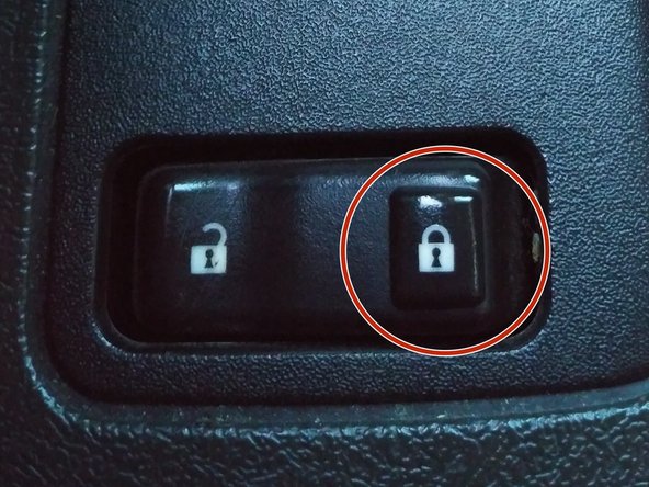

  5. The 2006 Chevy Silverado Key Fob Battery Replacement and Programming Guide: step 5, image 1 of 1
    • Press the vehicle lock button to ensure all doors of the vehicle are locked.

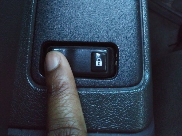

  7. The 2006 Chevy Silverado Key Fob Battery Replacement and Programming Guide: step 7, image 1 of 1
    • Press and hold the unlock button on the driver side door. Do not release until prompted to do so in Step 10.
    • Swiftly turn the ignition ON and OFF.
  8. The 2006 Chevy Silverado Key Fob Battery Replacement and Programming Guide: step 9, image 1 of 1
    • Release the unlock button on the driver side door. You should hear the vehicle automatically lock and then unlock.
