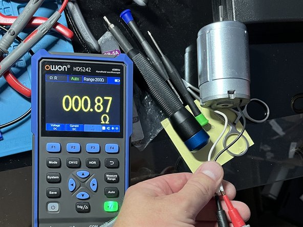

Testing the Circulation Motor 34020-61300
    1. Testing the Circulation Motor 34020-61300, Measuring the Internal Resistance of the Motor: step 1, image 1 of 2 Testing the Circulation Motor 34020-61300, Measuring the Internal Resistance of the Motor: step 1, image 2 of 2
      • Measure the internal resistance of the motor with the multimeter.
      • It should be around 2.6 ohms.
      • Less than 0.9 ohms indicates a defect.
