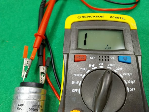

    1. Teka Dishwasher Water Pump (Recirculation Pump) Capacitor Testing, Teka Dishwasher Water Pump (Recirculation Pump) Capacitor Testing: step 1, image 1 of 3 Teka Dishwasher Water Pump (Recirculation Pump) Capacitor Testing, Teka Dishwasher Water Pump (Recirculation Pump) Capacitor Testing: step 1, image 2 of 3 Teka Dishwasher Water Pump (Recirculation Pump) Capacitor Testing, Teka Dishwasher Water Pump (Recirculation Pump) Capacitor Testing: step 1, image 3 of 3
      • 3 uF / 450V capacitor, why such a high voltage?: It does not mean that the capacitor will work at 450 V; that voltage means that the capacitor CAN WITHSTAND up to 450 V.
      • In this first check, I am going to check it with a capacitance meter, a device similar to a multimeter, but this one only measures capacitors (in each country, the capacitor is called something different).

    2. Teka Dishwasher Water Pump (Recirculation Pump) Capacitor Testing: step 2, image 1 of 2 Teka Dishwasher Water Pump (Recirculation Pump) Capacitor Testing: step 2, image 2 of 2
      • Checking the 3 µF capacitor with a capacitance meter: set the measuring device to the scale closest to, but immediately higher than, 3 µF; in this case, the 20 µF scale. If you set it to a scale lower than 3 µF, it will NOT measure.
      • Before connecting the capacitor to the measuring device, short its leads with pliers or a screwdriver. Even if the capacitor has been disconnected for hours or days, it may still hold a small voltage charge that could irreparably damage the measuring device. ATTENTION: THIS STEP IS BASIC AND VITAL.
      • In this case, this faulty, de-capacitated (low capacity = faulty) 3 µF capacitor shows a reading of 0.74 µF.
      Ask FixBot
    3. Teka Dishwasher Water Pump (Recirculation Pump) Capacitor Testing: step 3, image 1 of 2 Teka Dishwasher Water Pump (Recirculation Pump) Capacitor Testing: step 3, image 2 of 2
      • We already know it is faulty, but just to focus the measurement a little more, we lower the scale on the measuring device to the 2 µF scale, which gives us a reading of 0.718 µF.

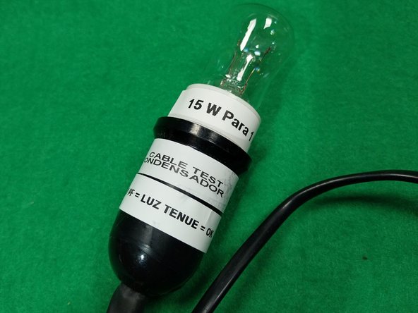

    4. Teka Dishwasher Water Pump (Recirculation Pump) Capacitor Testing: step 4, image 1 of 1

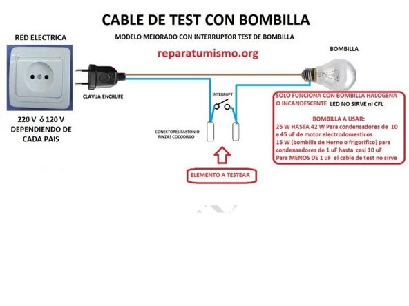

      • We have another “simple” capacitor testing method. It is not as reliable as a meter, but if we do not have anything else, this one is simple to build and cheap:
      • The test cable with a light bulb; in this case, a 15 W oven, refrigerator, or microwave bulb (all of those work; LED bulbs with electronics DO NOT WORK; a 25 or 42 W filament or halogen one works for us). WARNING: NEVER USE BULBS OVER 42 W.
      • Regarding this method to test capacitors, I have many videos on YouTube. It is a highly copied method. I highly doubt you will find a video earlier than 2010 that explains this method, but many insist, without providing any graphic evidence, that mine was not the first... we will leave the controversy there.
      • As you can see, this was the first video, of low quality since I did not record in digital format back then. It was my beginning on YouTube in the year 2010 and it is the 1st I filmed out of the many, more than 1450, that I have today HOMEMADE CAPACITOR TESTER CABLE, APPLIANCE CAPACITORS 1 of 5

    5. Teka Dishwasher Water Pump (Recirculation Pump) Capacitor Testing: step 5, image 1 of 3 Teka Dishwasher Water Pump (Recirculation Pump) Capacitor Testing: step 5, image 2 of 3 Teka Dishwasher Water Pump (Recirculation Pump) Capacitor Testing: step 5, image 3 of 3
      • Used 15 W lamp; a refrigerator, oven, or microwave oven lamp works.

    6. Teka Dishwasher Water Pump (Recirculation Pump) Capacitor Testing: step 6, image 1 of 3 Teka Dishwasher Water Pump (Recirculation Pump) Capacitor Testing: step 6, image 2 of 3 Teka Dishwasher Water Pump (Recirculation Pump) Capacitor Testing: step 6, image 3 of 3
      • WARNING: The alligator clips will carry mains voltage, so the capacitor must be connected with the cable DISCONNECTED from the mains.
      • Connect the power plug and observe the light the bulb produces:
      • With an OK capacitor, the 15 W bulb will light up to almost 100%. This is the same as if we were to close a nightstand lamp switch (this simply bridges the capacitor terminals).
      • A capacitor with low capacitance = damaged = faulty: the lamp will barely light up or the filament will not even turn on. FAULTY. Photos 2 and 3.
