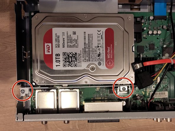

    4. Technisat HD-S2 hard disk replacement, Detach hard drive: step 4, image 1 of 3 Technisat HD-S2 hard disk replacement, Detach hard drive: step 4, image 2 of 3 Technisat HD-S2 hard disk replacement, Detach hard drive: step 4, image 3 of 3
      • Remove the two screws underneath the front cover
      • Remove the two screws which hold the hard disk to the bottom of the frame
      • The hard drive can now be removed including its metal frame. This frame is fixed with two screws on each side of the hard disk.
