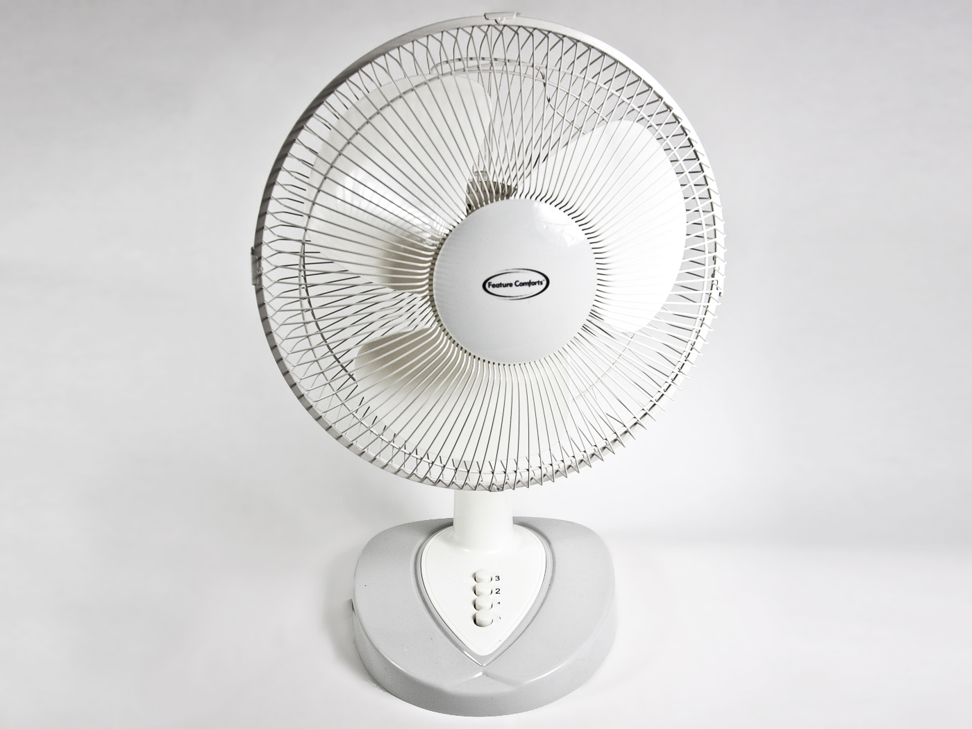

This teardown is not a repair guide. To repair your GD Midea FT30-3D, use our service manual.

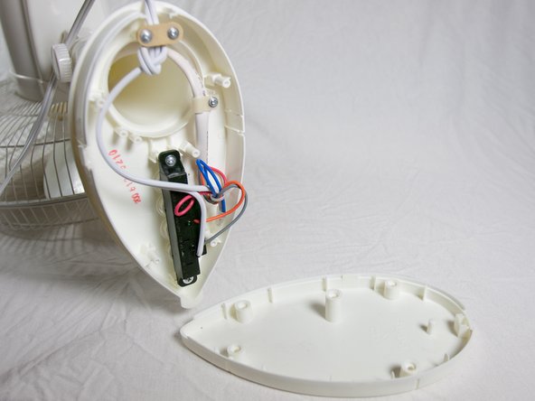

  6. Teardown of GD Midea FT30-3D: step 6, image 1 of 1
    • Once all five screws have been removed the base cover should fall right off with out any effort.
    • When putting the base cover back on; be careful to make sure that none of the wires are pinched.

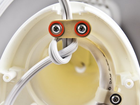

  7. Teardown of GD Midea FT30-3D, AC Power Cord: step 7, image 1 of 1
    • Remove the two 15 mm Phillips screws on the retention plate.
    • The tan retention plate will fall off once the screws are removed.
  8. Teardown of GD Midea FT30-3D: step 8, image 1 of 1
    • Take the 1.5 mm Flathead Screwdriver, or any thin elongated tool that fits into the semi-circular holes along side the AC power cord white wire. Press into the hole gently to release the grip on the wire.
    • The AC power cord wire should release with ease if done properly.

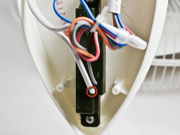

  9. Teardown of GD Midea FT30-3D: step 9, image 1 of 1
    • Cut the existing cable tie bundling the other AC power cord, red, orange, gray, and blue wires together.
    • Remove or cut the crimp connector connecting the blue wire and the AC power cord wire.
  10. Teardown of GD Midea FT30-3D, Power/Speed Switch: step 10, image 1 of 1
    • Remove the two 10 mm Phillips #1 screws found connecting the switch to the case.
    • Notice the AC power cord line (white wire) goes into the switch under the [Off] button
  11. Teardown of GD Midea FT30-3D: step 11, image 1 of 1
    • Take the 1.5 mm Flathead Screwdriver, or any thin elongated tool that fits into the semi-circular holes along side the wires. Press into the hole gently to release the grip on the wires.
    • The wires should release with ease if done properly.
    • When reassembling; skip this step.
