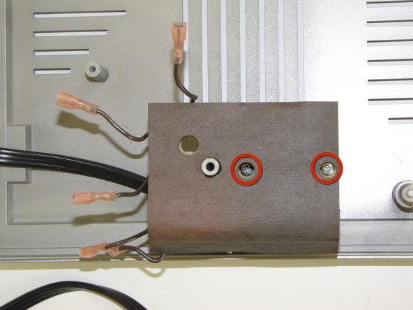

    • Remove the two 1.6 inch screws securing the transformer.

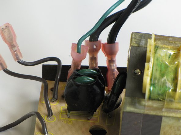

    • Remove the power cord's three leads from the transformer.
    • Note the orientation and color of the three leads. Make sure to replace these exactely as they were.

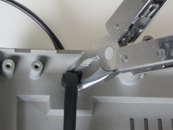

    • Using needle-nose pliers, pinch the tabs of the grommet holding the power cord to the case and push the grommet out.
    • Remove the entire length of cord from the case and replace with a new one.
