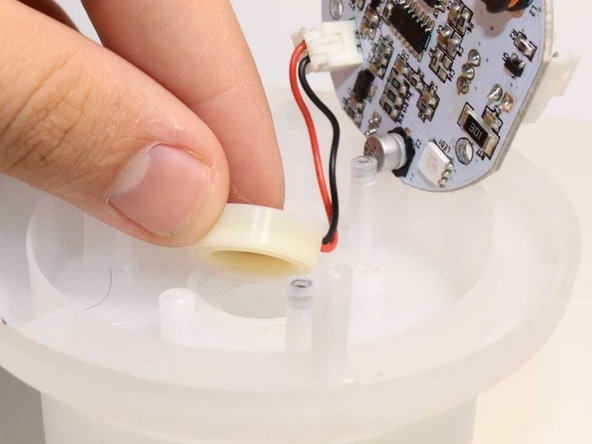

    7. Syntus ST150 Ultrasonic Plate Replacement: step 7, image 1 of 1
      • Remove the rubber cover from the ultrasonic plate.
      Ask FixBot
    8. Syntus ST150 Ultrasonic Plate Replacement: step 8, image 1 of 1
      • Now you can replace the ultrasonic plate of your diffuser.
