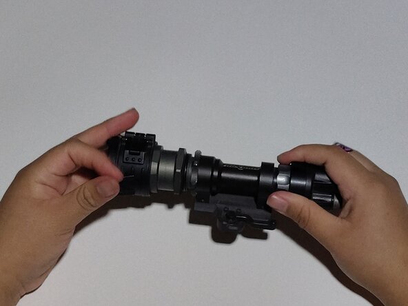

Follow this guide to replace the light bulb in the Surefire M951, ensuring bright illumination for your future trips.
    1. Surefire M951 Lightbulb Replacement, Surefire M951 Lightbulb: step 1, image 1 of 3 Surefire M951 Lightbulb Replacement, Surefire M951 Lightbulb: step 1, image 2 of 3 Surefire M951 Lightbulb Replacement, Surefire M951 Lightbulb: step 1, image 3 of 3
      • Maintain the flashlight on a plane surface
      • Unscrew the head counterclockwise
      Ask FixBot

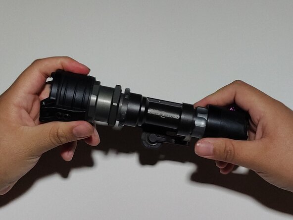

    2. Surefire M951 Lightbulb Replacement: step 2, image 1 of 2 Surefire M951 Lightbulb Replacement: step 2, image 2 of 2
      • Separate the flashlight head from the body
      Ask FixBot
