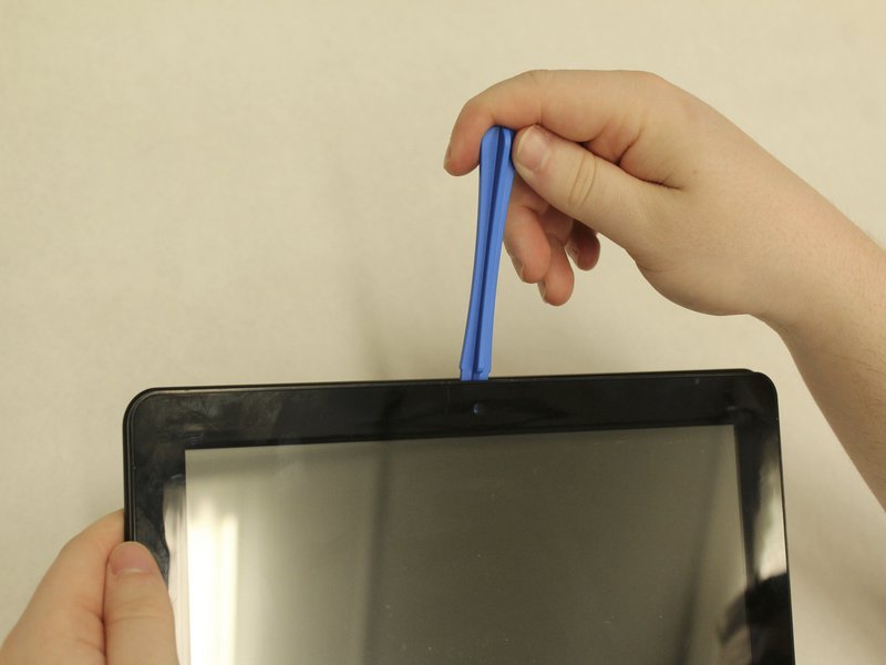

In this replacement guide, we will show you how to remove the back cover and all of the inside components of your tablet in order to replace the back cover.
Tools
    1. Supersonic Matrix SC-91MID Back Cover Replacement, Back Cover: step 1, image 1 of 1
      • To begin, insert the plastic opening tool between the display and back cover and apply force until the back cover comes free from the device.
