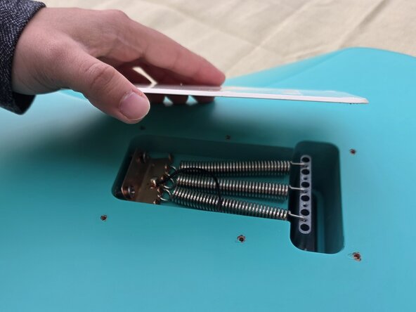

Stratocaster Loose Switch Wire Reattachment
    1. Stratocaster Loose Switch Wire Reattachment, Stratocaster Loose Switch Wire Reattachment: step 1, image 1 of 3 Stratocaster Loose Switch Wire Reattachment, Stratocaster Loose Switch Wire Reattachment: step 1, image 2 of 3 Stratocaster Loose Switch Wire Reattachment, Stratocaster Loose Switch Wire Reattachment: step 1, image 3 of 3
      • Remove the screws from the backplate on the back of the guitar.
      • Fully remove the backplate and set it aside.

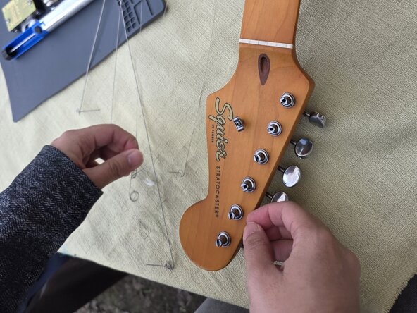

    2. Stratocaster Loose Switch Wire Reattachment: step 2, image 1 of 2 Stratocaster Loose Switch Wire Reattachment: step 2, image 2 of 2
      • Fully loosen all guitar strings by turning the tuning pegs towards the body when held in the orientation of the picture.
      Ask FixBot

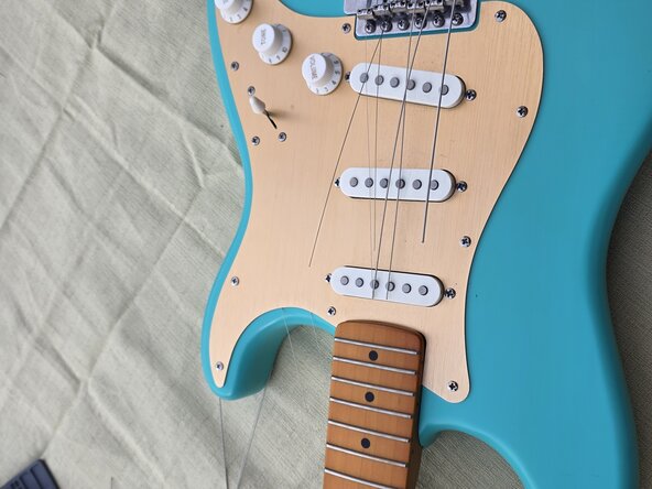

    3. Stratocaster Loose Switch Wire Reattachment: step 3, image 1 of 3 Stratocaster Loose Switch Wire Reattachment: step 3, image 2 of 3 Stratocaster Loose Switch Wire Reattachment: step 3, image 3 of 3
      • Insert a finger under the strings to create some slack.
      • Use pliers to cut through each of the strings.
      Ask FixBot
    4. Stratocaster Loose Switch Wire Reattachment: step 4, image 1 of 2 Stratocaster Loose Switch Wire Reattachment: step 4, image 2 of 2
      • Remove the strings from the guitar tuning pegs.

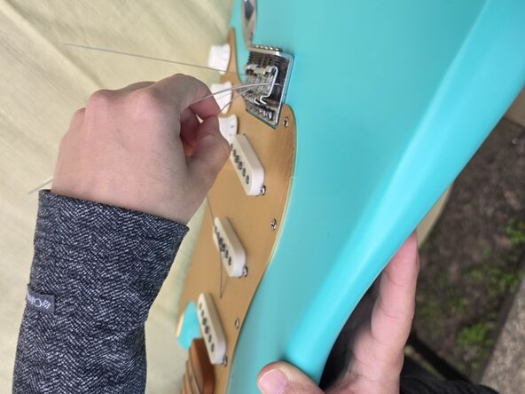

    5. Stratocaster Loose Switch Wire Reattachment: step 5, image 1 of 3 Stratocaster Loose Switch Wire Reattachment: step 5, image 2 of 3 Stratocaster Loose Switch Wire Reattachment: step 5, image 3 of 3
      • From the front, push in the guitar strings until they peek out of the back.
      • From the back, pull the guitar strings all the way out.

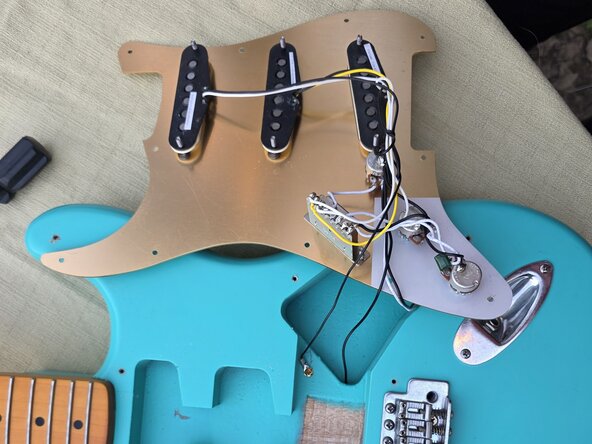

    6. Stratocaster Loose Switch Wire Reattachment: step 6, image 1 of 3 Stratocaster Loose Switch Wire Reattachment: step 6, image 2 of 3 Stratocaster Loose Switch Wire Reattachment: step 6, image 3 of 3
      • Remove all of the screws from the front panel.
      • Fully remove the front panel to reveal wires and the switch circuit board.

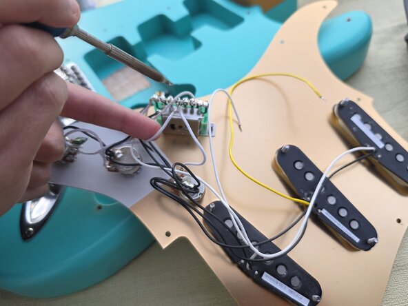

    7. Stratocaster Loose Switch Wire Reattachment: step 7, image 1 of 3 Stratocaster Loose Switch Wire Reattachment: step 7, image 2 of 3 Stratocaster Loose Switch Wire Reattachment: step 7, image 3 of 3
      • Identify the loose string and which lug (point on the switch) it needs to be reattached to. It will be the one that doesnt have a string attached.
      • Re-solder the loose wire to the switch.
