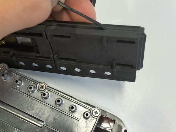

      • Once all of the screws keeping the casings together are detached, use a thin and flexible object such as a card or an opening tool to separate the two sections.
      • Only pull apart the two parts once you have fully gone around with the card to avoid anything breaking. The heating plate will want to stay with the black casing hence slowly push it through the hole as it is mainly connected to the white casing along with the wires and pump.

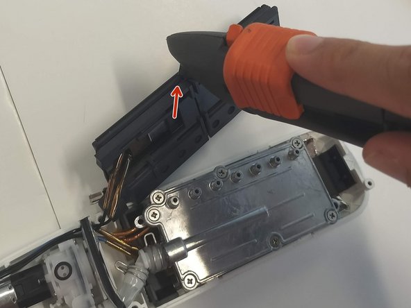

      • Identify and unscrew the single silver Phillips screw(M2.4X5.5) located on the heating plate. This keeps the rubber sealing and the main heating element.
      • Remove lightly the rubber section then we will be able to easily separate the top black part which contains the PTC plate and the bottom silver section which consists of a steam chamber and another PTC heating element.
      • Try to remove the rubber sealing which was wrapped around the two heater support. In this case it happened that they were glued together, making it impossible to access the next part if we didn't get rid of it.

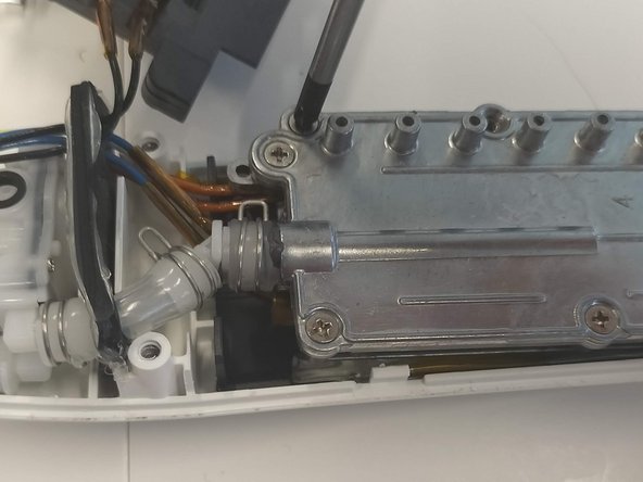

      • Onto the tubing and pump section, use needle-nose pliers to squeeze the metal clamps around the tube and release them in the middle. This will facilitate the disassembly of the tubes.
      • Locate the opaque rubber section which serves as connecting between the water reservoir and the pump system. Pinch the sides and gently lift it out of its support. You will be able to dislodge the entire system now, which will allow for more space to work with

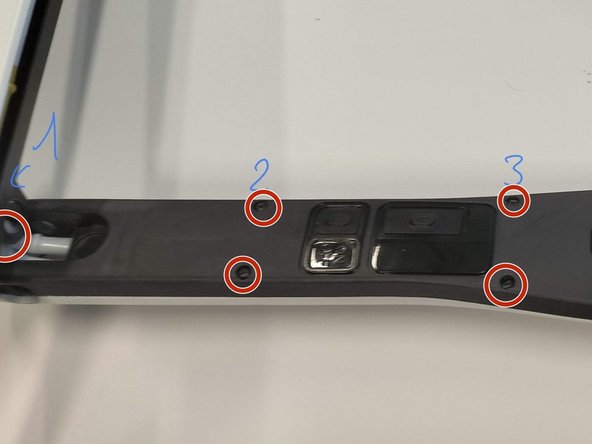

      • Onto the upper section, turn around the product as to get locate the screws holding the black and white casing together.
      • There is a total of 9 screws (4 pairs + one large located at the bottom). They are all of different size hence multiple screwdrivers will be needed again.
      • No.1&4: M3.0X8
      • No. 2&3 : M1.6X8
      • No. 5: M1.8X6

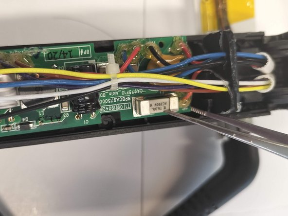

      • Use a pair of tweezers to get underneath the circuit. Use them as a kind of lever to push the circuit out of its support. Do proceed with care as the board is relatively thin and brittle which increases the risk of it snapping or breaking.
      • Another precaution might be when handling metallic tools with relatively sharp edges, handle with care as to not scratch or damage the circuit and the small components.
      • Once both edges are lifted, simply pull the black rubber sealing which is located in between the circuit and the heating plate.

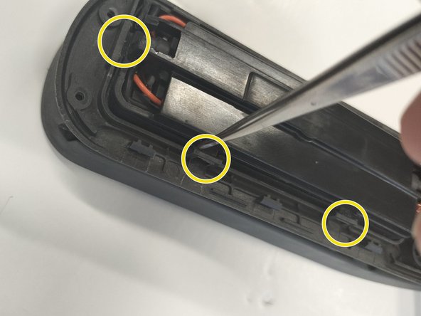

      • Similarly to removing the circuit board, use a pair of small tweezers which can get in between the main heating plate and the casing which holds it in place with the help of finger joints.
      • There are a total of 7 joints which keeps it in place, but you only need to take care of the bottom part first (closest to the circuit board) and the side which only has 2. They can be hard to locate and quite tricky to remove so take your time to avoid causing any damage.
