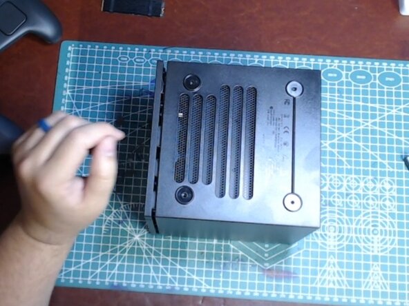

    1. Steam Machine (2nd Generation) M.2 SSD Hard drive Replacement, Remove Rubber Feet/Screws: step 1, image 1 of 2 Steam Machine (2nd Generation) M.2 SSD Hard drive Replacement, Remove Rubber Feet/Screws: step 1, image 2 of 2
      • Remove the 4 screws that are part of the rubber feet on the bottom of the steam machine.
      • These screws are held captive inside their rubber and plastic feet material. They are NOT captive to the shell of the machine, and need to be completely removed.

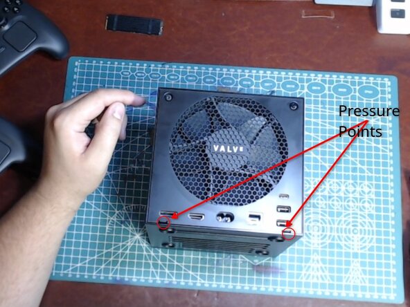

    2. Steam Machine (2nd Generation) M.2 SSD Hard drive Replacement, Remove Backplate: step 2, image 1 of 2 Steam Machine (2nd Generation) M.2 SSD Hard drive Replacement, Remove Backplate: step 2, image 2 of 2
      • The Top 2 screws on the back plate are captive. Loosen them until they spin freely, they may sag in place.
      • At the Bottom of the backplate, there are 2 pressure friction points that hold the plate in place. Use a spudger, or other flat tool to gently pry the bottom of the shell away from the metal backplate.
      • When the screws are free, and the pressure points are released, the backplate should lift off.

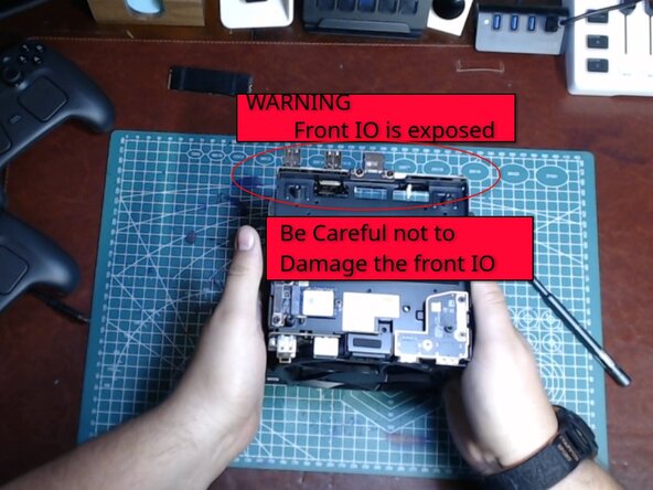

    4. Steam Machine (2nd Generation) M.2 SSD Hard drive Replacement, Drive Replacement: step 5, image 1 of 2 Steam Machine (2nd Generation) M.2 SSD Hard drive Replacement, Drive Replacement: step 5, image 2 of 2
      • WARNING : The front IO of the steam machine is very exposed at this point of the process. Be careful not to bump it, or lean the machine against the front IO ports. There is a high chance of snapping or damaging them.
      • Gently rotate the machine to "stand on its head" so the bottom of the machine is facing upwards. This exposes the SSD.
      • Remove the retaining screw that is keeping the original drive depressed and seated in the m.2 port.
      • The drive should spring upward. Gently pull it straight away from the port.
      • If installing a 30mm drive, you dont need to adjust the standoff.
      • If installing an 80mm drive, you will need to move the standoff to the correct position.
      • WARNING: THERE ARE NO STANDOFF POSITIONS FOR OTHER SIZES
      • Install the new drive at a slight upward angle, when the notch on your drive hovers over the standoff, press it down and reinstall the retaining screw.
