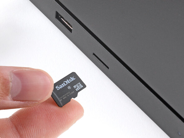

      • Before you begin this repair:
      • Power down your Steam Machine and disconnect the power cable.
      • Unplug any remaining cables or accessories from all ports.
      • If you have a microSD card installed, remove it. Otherwise, it may break during this procedure.

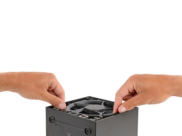

    5. Steam Machine (2026) Front Port Cover Replacement, Remove the inner assembly: step 8, image 1 of 3 Steam Machine (2026) Front Port Cover Replacement, Remove the inner assembly: step 8, image 2 of 3 Steam Machine (2026) Front Port Cover Replacement, Remove the inner assembly: step 8, image 3 of 3
      • After removal, don't lay the inner assembly down on the microSD and USB ports. These ports are fragile and shouldn't have the weight of the assembly resting on them.
      • Grip the inner assembly under the fan and lift it straight up and out of the shell.
      • Set the inner assembly down so the SSD is on top.

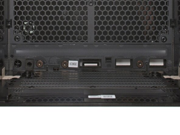

    1. Steam Machine (2026) Front Port Cover Replacement, Remove the front port cover screws: step 9, image 1 of 2 Steam Machine (2026) Front Port Cover Replacement, Remove the front port cover screws: step 9, image 2 of 2
      • Use a T8 Torx screwdriver to remove the three 5.1 mm‑long screws securing the front port cover.
      Ask FixBot

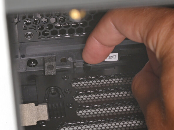

    3. Steam Machine (2026) Front Port Cover Replacement, Unclip the front port cover: step 11, image 1 of 3 Steam Machine (2026) Front Port Cover Replacement, Unclip the front port cover: step 11, image 2 of 3 Steam Machine (2026) Front Port Cover Replacement, Unclip the front port cover: step 11, image 3 of 3
      • Two plastic clips secure the front port cover to the shell.
      • Use your finger to push both clips in to release them.
