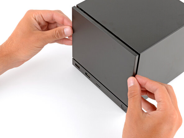

Follow this guide to remove or replace the faceplate on your Valve Steam Machine (2026).
    1. Steam Machine (2026) Faceplate Replacement, Remove the faceplate: step 1, image 1 of 3 Steam Machine (2026) Faceplate Replacement, Remove the faceplate: step 1, image 2 of 3 Steam Machine (2026) Faceplate Replacement, Remove the faceplate: step 1, image 3 of 3
      • The faceplate is held in place with four strong magnets near the corners.
      • Firmly pull the faceplate away from the console to remove it.
