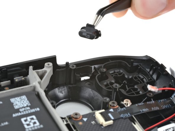

    1. Steam Deck OLED View Button Replacement, Remove the view button: step 26, image 1 of 2 Steam Deck OLED View Button Replacement, Remove the view button: step 26, image 2 of 2
      Tool used on this step:
      Buy
      • Use tweezers to remove the view button.
