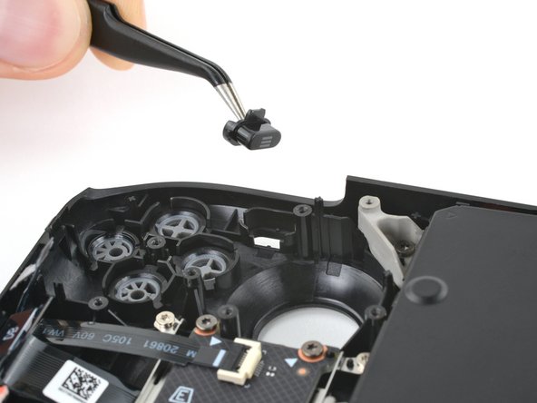

    1. Steam Deck OLED Menu Button Replacement, Remove the buttons membrane: step 23, image 1 of 2 Steam Deck OLED Menu Button Replacement, Remove the buttons membrane: step 23, image 2 of 2
      • If the action and menu buttons membrane stayed on the bumper bracket, skip this step.
      • Remove the action and menu buttons membrane from the frame.
      Ask FixBot
    1. Steam Deck OLED Menu Button Replacement, Remove the menu button: step 24, image 1 of 2 Steam Deck OLED Menu Button Replacement, Remove the menu button: step 24, image 2 of 2
      Tool used on this step:
      Buy
      • Use tweezers to remove the menu button.
      Ask FixBot
