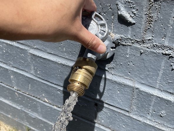

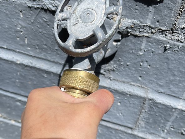

    • Confirm that the spigot is leaking from the vacuum breaker, and not a different component. Look specifically between the hose and vacuum breaker connection.
    • Disconnect the hose and ensure the spigot is turned off.
