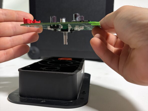

    6. Soundboks 4 PCBA Replacement, Unscrew the Screws: step 6, image 1 of 3 Soundboks 4 PCBA Replacement, Unscrew the Screws: step 6, image 2 of 3 Soundboks 4 PCBA Replacement, Unscrew the Screws: step 6, image 3 of 3
      • Using a 2mm Hex, unscrew all screws - 4 in total.
      • Remove the PCBA from the plastic housing

    7. Soundboks 4 PCBA Replacement, Mount the New PCBA: step 7, image 1 of 3 Soundboks 4 PCBA Replacement, Mount the New PCBA: step 7, image 2 of 3 Soundboks 4 PCBA Replacement, Mount the New PCBA: step 7, image 3 of 3
      • 4 Screws back in - don't over-tighten!
      • Antenna cable back on - use a zip-tie and cut of the excess
      • Add a small drop of silicone glue (at the red arrow)
      • If using a glue substitute, make sure it is not corrosive or hot-glue
