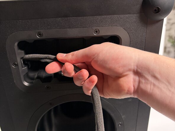

    4. Soundboks 4 DC Cable Replacement, Untie the wire harness: step 4, image 1 of 1
      • Untie the wire harness
      • Make sure to tie the wire harness once re-assembling it
      Ask FixBot

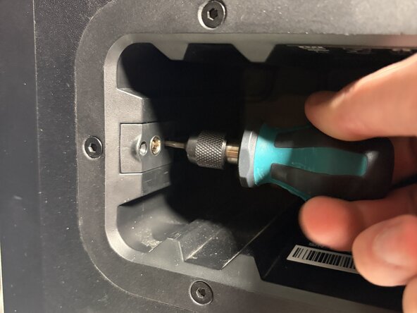

    5. Soundboks 4 DC Cable Replacement, Remove the DC Connector: step 5, image 1 of 3 Soundboks 4 DC Cable Replacement, Remove the DC Connector: step 5, image 2 of 3 Soundboks 4 DC Cable Replacement, Remove the DC Connector: step 5, image 3 of 3
      • Unscrew the DC plug connector with the 2mm Hex bit - 2 screws
      • Pull the connector and wire all the way out.

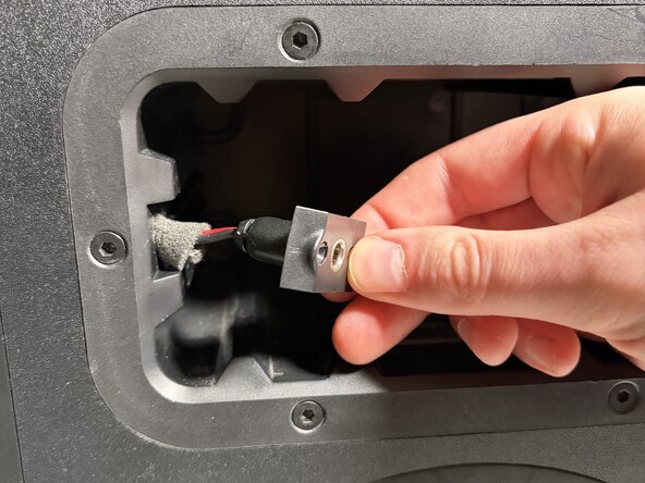

    6. Soundboks 4 DC Cable Replacement, Insert and fasten the new wire: step 6, image 1 of 3 Soundboks 4 DC Cable Replacement, Insert and fasten the new wire: step 6, image 2 of 3 Soundboks 4 DC Cable Replacement, Insert and fasten the new wire: step 6, image 3 of 3
      • You must insert the wire in the speaker - before assembling the wire
      • Insert and fasten the new DC Plug with the 2mm Hex screws
      • Do not over-tighten the screws

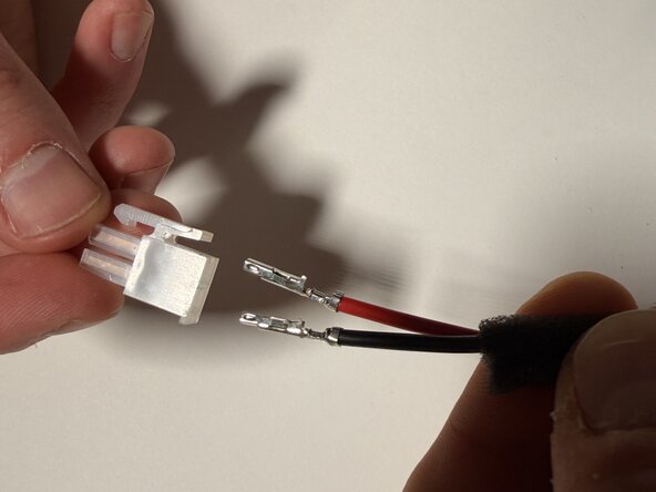

    9. Soundboks 4 DC Cable Replacement, Connector assembly: step 9, image 1 of 3 Soundboks 4 DC Cable Replacement, Connector assembly: step 9, image 2 of 3 Soundboks 4 DC Cable Replacement, Connector assembly: step 9, image 3 of 3
      • Make sure the red cable is placed as indicated in the picture
      • Plug the wire as indicated, make sure the molex crimps face towards the molex clip
      • Push the cables into the connector until you hear a "click"
      • It only fits in one direction - make sure you hear the click and check it!
      • Check: Pull the wires (medium strenght), to check that they don't come out.
